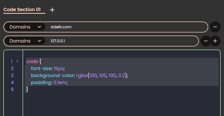

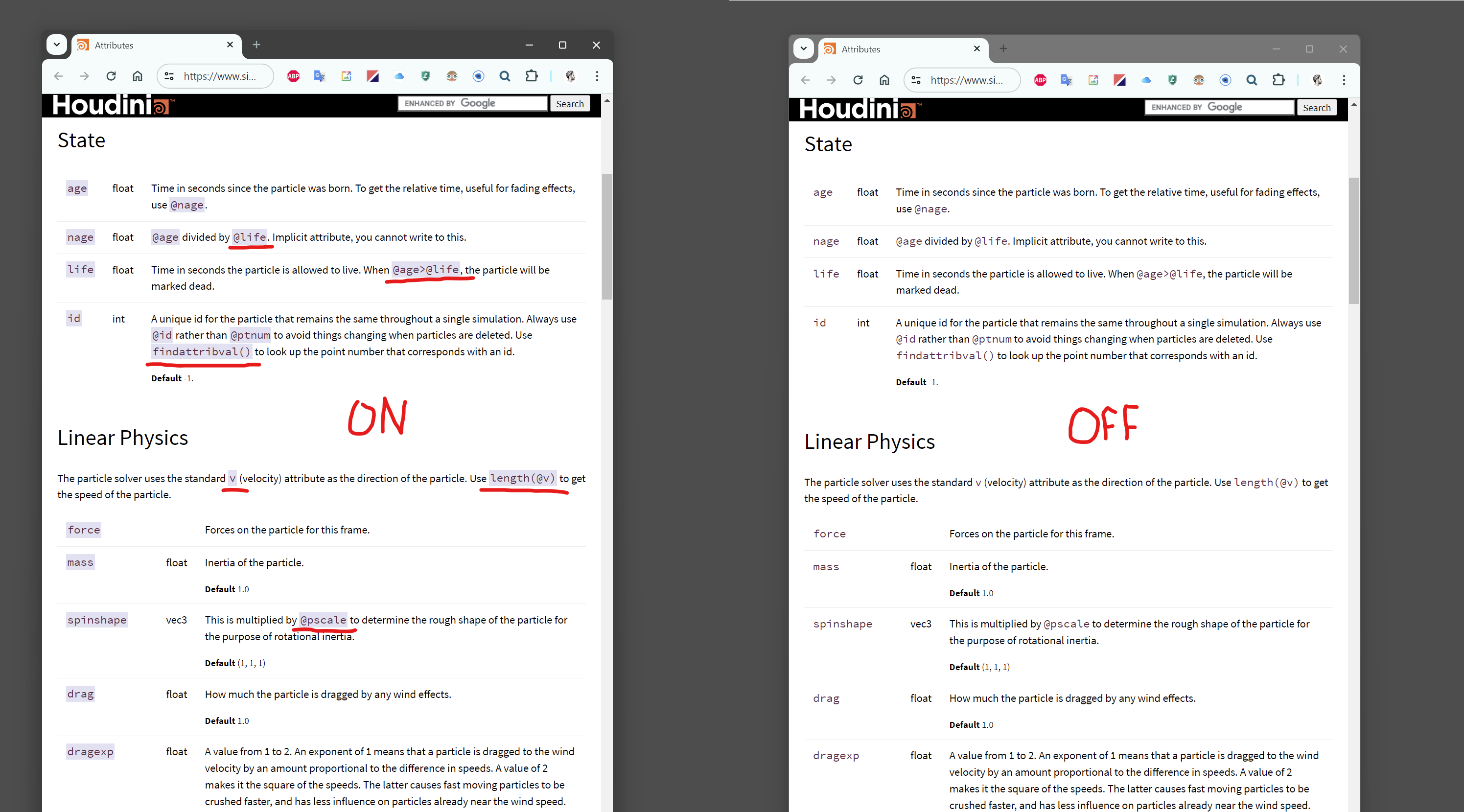

I use Chrome custom "Stylish" extension:
code {
font-size: 15px;
background-color: rgba(100, 100, 190, 0.2);
padding: 0.1em;
Screenshot 2024-05-15 091948.png (507.8 KB)
Screenshot 2024-05-15 092125.png (34.0 KB)
