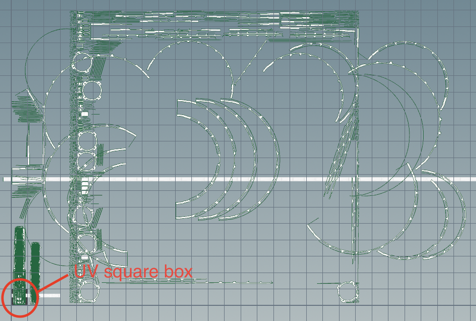

I'm trying to wrap my head around this and so far everything seems incredibly convoluted and unnecessary, so I thought I'd ask here for a better way.
I use a lot of pre-made geometry from various kit bash collections like Kitbash3D, Turbosquid, etc.
Typically the models come in pre-UV wrapped with UV attributes already in place. The problem is that when I take a look at the UV maps in Houdini, they all seem to overlap and extend far beyond the typical UV tile (see attached image) – this doesn't even make sense to me – shouldn't an object's surface all fit neatly into a single UV tile?!? How can a UV map contain overlapping and out-of-bound geometry?
This weird UV's in turn seem to wreck havoc with Substance Painter when I tell it to bake maps such as AO, Curvature, Normals, etc. which return jumbled and messy without actually matching the geometry.
I'm just looking for a way to get proper UV maps from Houdini into Substance Painter so that I can get Substance Painter to bake proper AO and Curvature maps so that in turn I can use smart materials and masks effectively.
Can anyone point to a proper UV workflow to go from Houdini into Substance Painter or other external paint app?

Here's what I suspect is happening:
1. Most of these assets are likely modeled in something like Maya, where I think that it's common to use multiple UV sets for any given geometry.
2. Houdini imports the FBX files with the multiple UV maps. From reading and googling, I found that there used to exist a Layer Node that would allow the user to separate the various UV maps, but such node no longer exists.
3. Substance Painter in turn doesn't recognize multiple UV maps, just reads UV 0 and calls it a day. I suspect this is causing the weirdness when I bake Normal, AO and Curvature maps which are being then mapped back incorrectly.
So…
I think that there are two possible solutions:
A. Use UVLayout to either remap the various UV maps into a single UV Tile, or alternatively create a set of UDIM Tiles for export into Substance Painter (which recently acquired the ability to work with UDIM Tiles).
B. Delete the existing UV Attribute, and then use something like LABS AutoUV's to generate a brand new UV Map that is correctly laid out on a single UV Tile and export that to Substance Painter.
Either way, it seems like a convoluted PITA. Does anyone know a better way?

those uvs don't look correct for any workflow
multiple uv sets are still contained to 0-1 uv space and UDIMs would not have polygons crossing any uv tile's boundaries
also while Layer SOP is gone, there is a newer workflow for multiple uv sets in Houdini, so when importing geo with multiple uv sets it should simply come in as multiple vector attributes marked as (Tex) whatever the names
if you have overlapping uvs, it probably means that they come from multiple objects, importing obj or fbx with multiple objects will probably create prim groups so you can distinguish them individually, and fit the uvs to 0-1 tile for each of them
also exporting .obj with multiple prim groups should export them as individual objects, but maybe it's better to create s@path attribute based on those groups and export as .abc

Ok, so this is what I came up with which seems to fix my issue:
1. Use the Blast Node to get rid of UV sets for the other material groups, as well as geometry groups for each of my material groups (in this case 3 groups)…I also recompute the normals while I'm at it because why not?
2. Use UV Layout to arrange each of the individual UV sets into a single UV 0-1 Tile. This is annoyingly time consuming but what the hell!
3. Merge the 3 branches back into one, add a Material node which I can then assign 3 different materials so that Substance Painter will be happy.
This appears to get me a workable set of UV maps so that Substance Painter can compute and bake proper AO, Normal and Curvature maps!
Whew….now I still don't understand why the FBX UV sets are so gigantic and go way over the 0-1 UV Tile as shown in my first image.

glitchi
i generally don't get UV problems on import. might be a case with that particular kitbash asset of yours - outdated fbx or some pre-historic max file format shenanigans - who knows!
thankfully you resolved it.
I gotta tell you, they're all like that – KitBash3D, Gumroad, Turbosquid, all of the UV's come in looking weirdly oversized. Now, to be clear, this is not a problem when the plan is to remain within Houdini, everything will map out correctly and there shouldn't be any issues. The problems come in when exporting to Substance Painter, and asking SP to generate AO and Curvature maps which then get re-mapped weirdly to the geometry. I think the issue is more with how SP interprets the UV maps than how Houdini does…but it's an issue nonetheless.
>>Kays

Sounds strange, honestly … are you importing OBJ or another format? OBJ would allow you to simply open the file in a text editor and have a quick peek at the ACTUAL UV data, so you could check if it's a problem in Houdini or with the files.
Do you have an example link where one could download such a “wonky file” without having to register first?
Marc
Marc

- Midphase
- 833 posts
- Joined: Jan. 2018
Here's an .fbx file as an example. Import using the File Node and take a look at the UV view.
>>Kays
- malbrecht
- 806 posts
- Joined: Oct. 2016
Definitely not a Houdini-problem:
… I wonder if that is a “standard” on those sites you are downloading from. I mean … this isn't exactly something I would pay money for.
Marc
Marc
