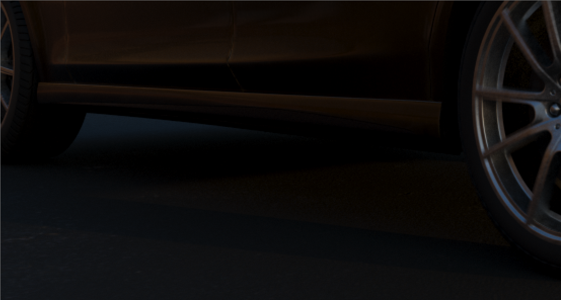

Here's a screenshot of a cropped render linear .exr being displayed in Nuke with the (Aces 1.1) Rec 709 display transform, right next to the same .exr being displayed in Mplay with the Rec 709 display transform:
See how all the detail in the shadow area beneath the car and also along the wall of the tyre are being almost completely crushed to black in the Mplay viewer, which displays the same in the Renderview inside Houdini.
I'm using the Aces 1.1 default OCIO config file.
In that config file, the scene_linear role is set to: ACES - ACEScg
My system $OCIO environment variable is set correctly to point to the config file, and Houdini and Nuke are picking that config file up and are configured correctly as far as I can tell.

Sampling in the toe of the curve is definitely subpar when viewing through OCIO display. What surprised me, is that even applying the OCIO transform in VEX with 32 bit color using a VOP COP has clipped shadows as compared to other software. I have compared to Affinity photo as it is the only other OCIO aware software I have at the moment.

I'm not sure technically what the issue is but from a practical standpoint it's definitely problematic for me because it means I can't trust what I see in the Renderview through the OCIO display transform.. since it looks different than when viewed in other software such as Nuke with the same OCIO display.
As mentioned the dark areas lose a lot of detail in the Mplay and Houdini Renderview
This was fixed in 18.5.379. Edit: and 18.0.624.
