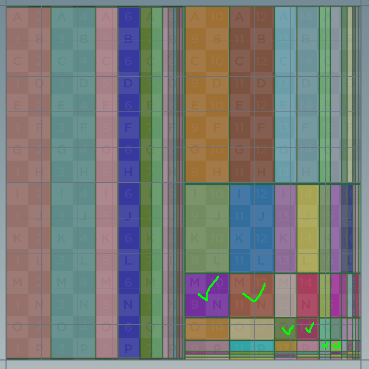

Another bit of feedback with the automatic_trim_texture node is I'm getting poor results with adjusting the fitting preference.
The texture I'm using is similar to a workflow Id Software uses, where they use trim textures with defined UV region "hotspots", and a custom script for Modo then picks the best UV region for all the quads.
The UV hotspots are picked based on either best aspect ratio fit, or closest target texel density (when applied to the surface). There is also a similar script for Blender now.
I'm applying the automatic trim texture HDA to a cube using this trim texture and I would expect the Quad regions to have highest priority (marked with green checkmarks).
The texture may look like overkill, as it has 96 trim sections, but it is the same exact layout that Id Software uses.
It is intended for generic surfaces, handling a bunch of different aspect ratios and texel densities. (Then you might have various materials which use the same layout and just swap the material without changing UVs)
When adjusting the Fitting Preference from 0 to 1 (width to height) it really has no affect on the fit, same with Area.
The trim pieces selected end up being highly vertical strips which don't make sense for the square sides of a cube.
