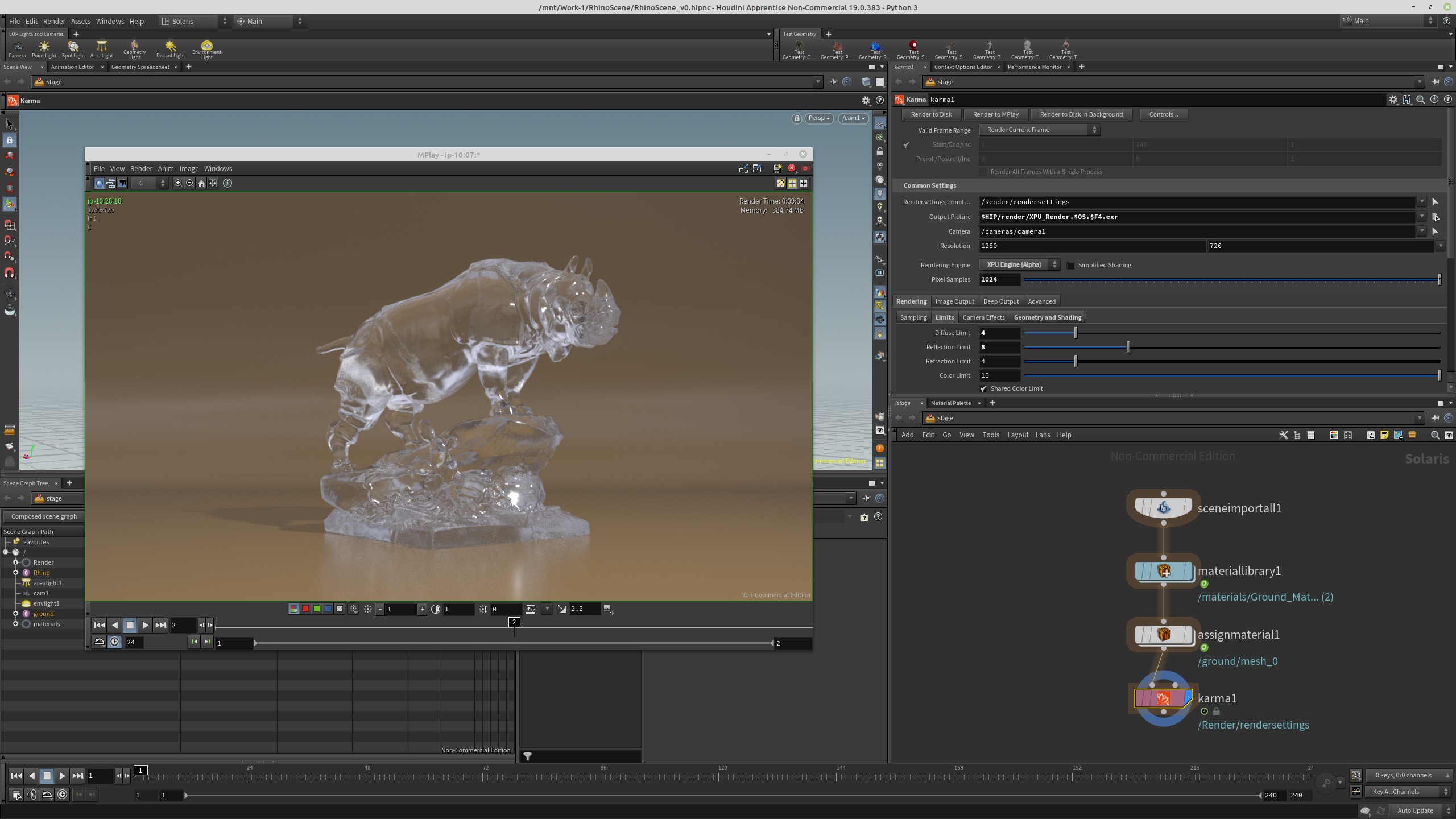

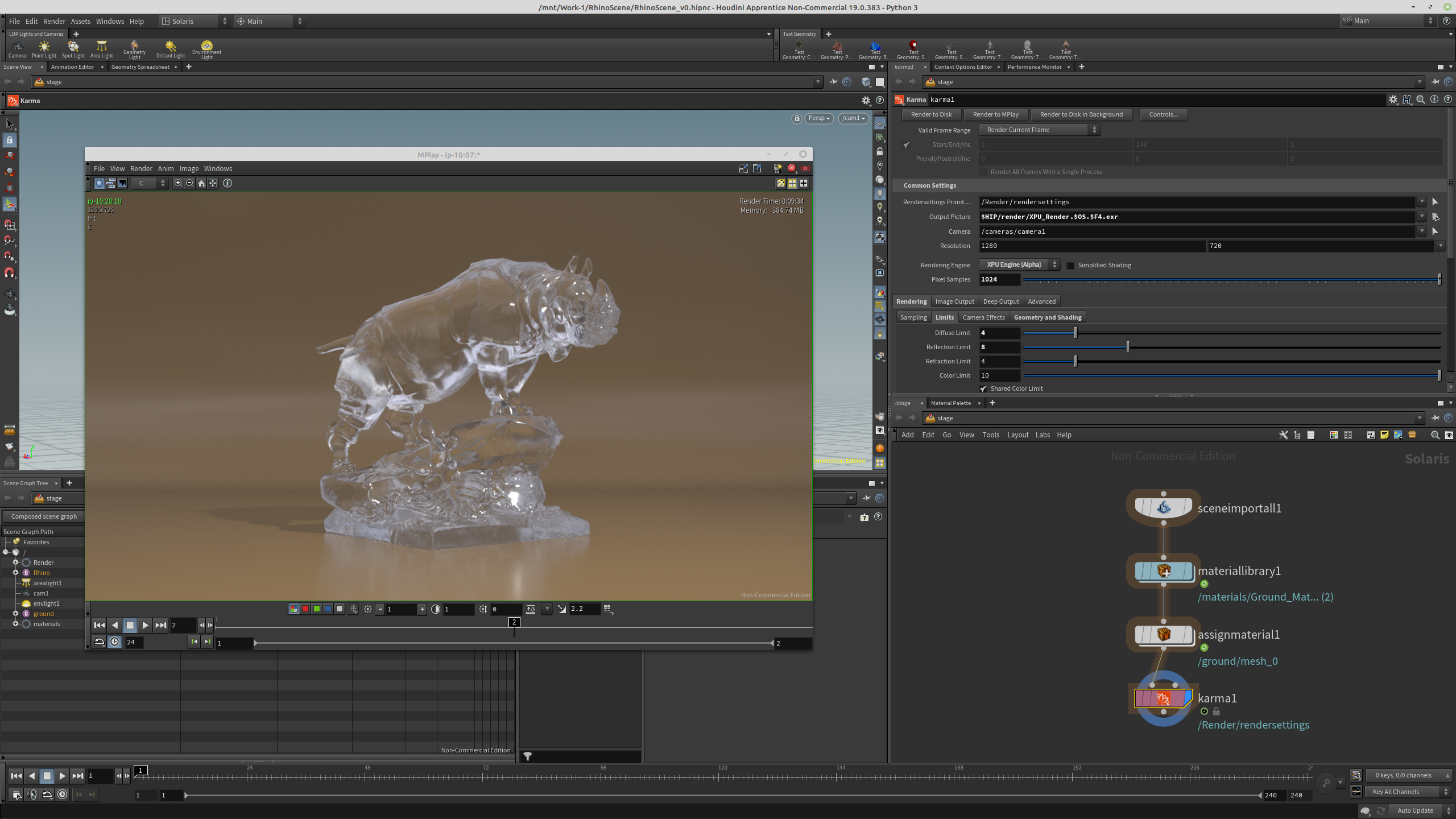

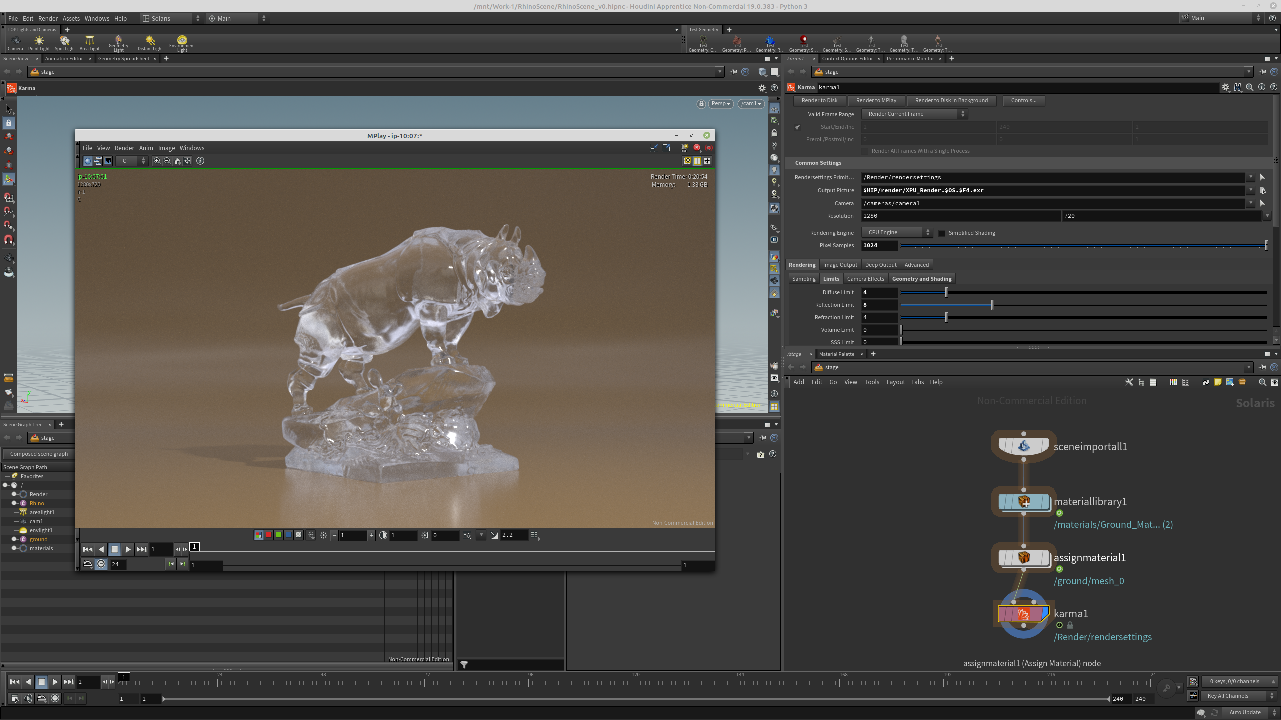

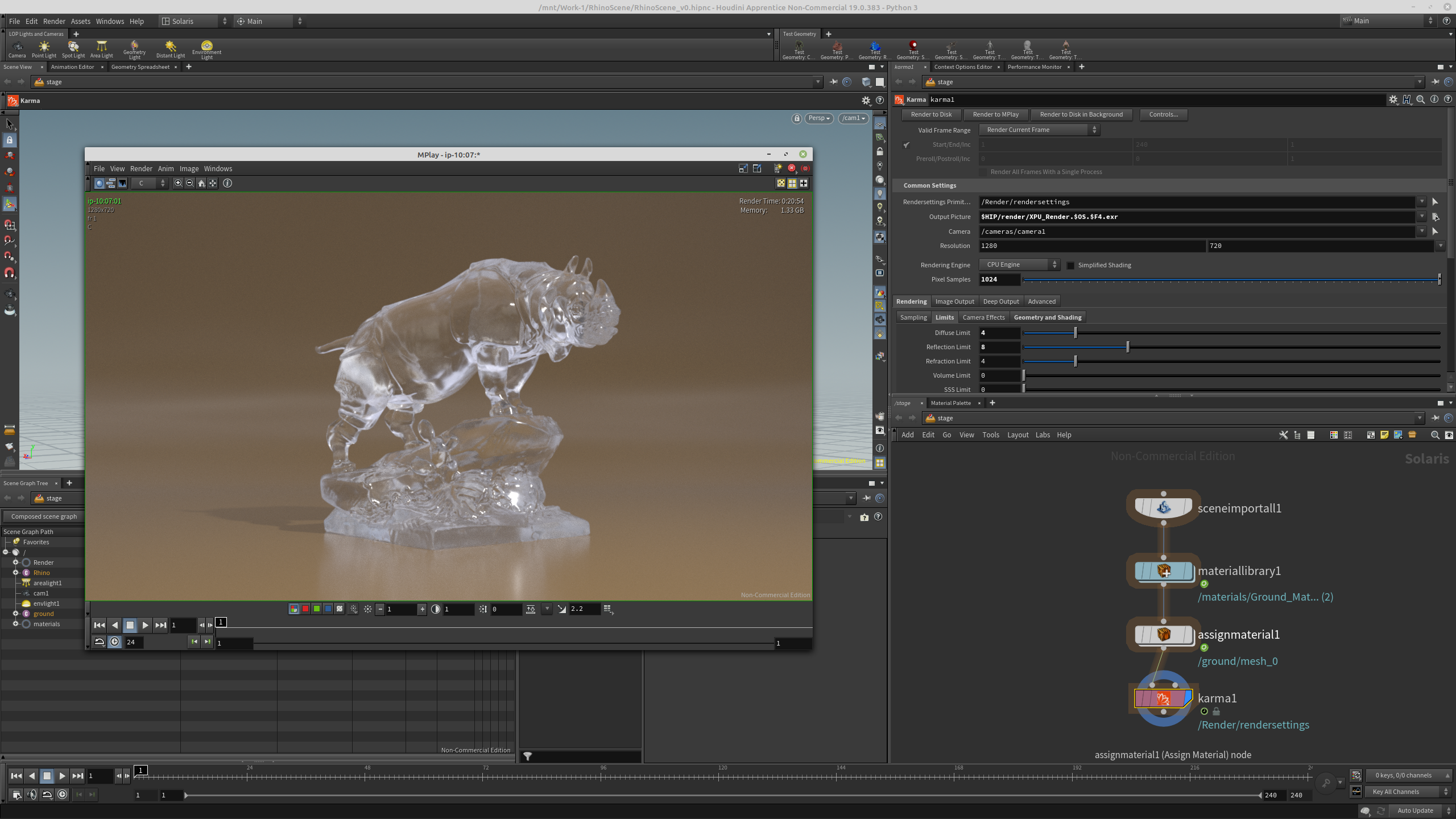

I just installed Linux Mint 20 for testing H19, and it started flawlessly, I rendered a test scene and it went crazy fast compared to Windows 10 Workstation on my AMD 8 cores workstation with a GTX 1650!
CPU:
Linux 20:54
Windows 55:07
XPU:
Linux 09:34
Windows 10:49
Screenshot from 2021-11-05 10-27-59.png (1.7 MB)
Screenshot from 2021-11-05 10-37-56.png (1.4 MB)
