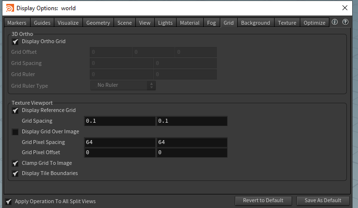

Press D in the viewport to get display options.
Then go to grid, click display Ortho Grid (it might be already on, but if it is it probably isn't your default), then importantly, click save as default.
Just it! Thank you!
