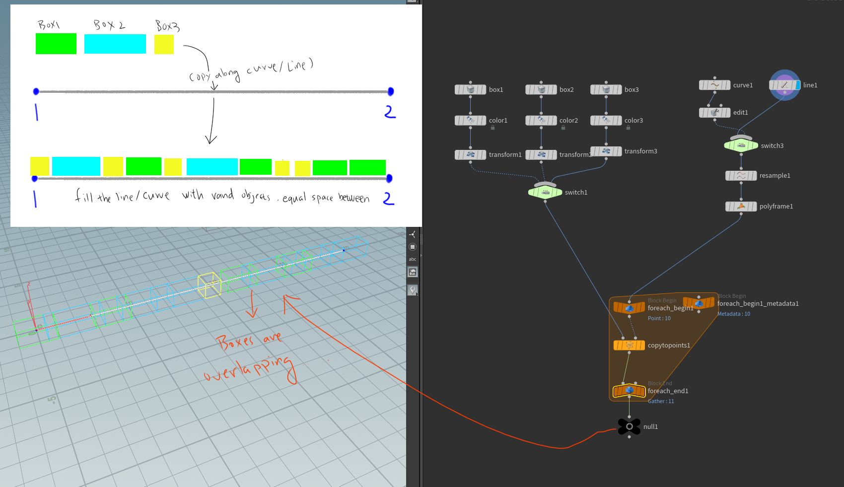

I want to random copy a few existing models along a line/curve.
The line/curve has to be a fixed distance/length, but the models/bbox size can change.
while copying objects…..I want to use model's bounding box, so I have control of the space between instance 0 and instance 1, and they don't overlap
I use copy-to-point node, but I know think it will work.
for-each-loop, may work, but I not sure how to feed the bbox value back to the “resample” node???? sorry I don't know if this make any sense….
I made a diagram here, hope it explained what Im trying to do…
Thank you very much
Screenshot at 2020-09-01 11-36-27.png (585.8 KB)
Project1.hip (144.5 KB)

try adding the labs align and distribute after the fact, obviously spacing 0….(or whatever)
504 posts
here is an example with a random selection of objects aligned to a curve using the new path deformer.
curve_random_copyA.hipnc (420.5 KB)

I am speechless and thank you both “vusta” & “Aizatulin”
Thanks vusta for letting me know about “align and distribute” fro lab, it is definitely useful.
Aizatulin, omg, what you have in the sample is blow my mind. I was too naive. Thanks for spending time and show me how it can be done, and I have a lot need to digest now, lots of good information and tricks. Amazing, thank you so much!

There is now a Chain [www.sidefx.com] sop that can do this and more
