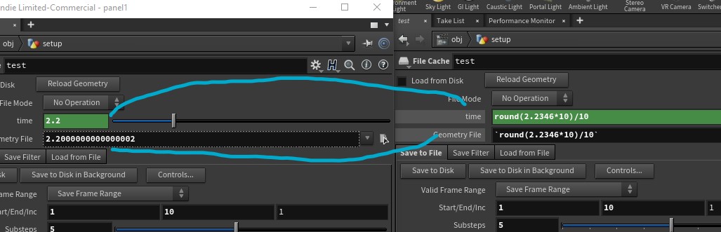

Caching sub steps using the file cache node doesn't seem like a full proof solution if you want to cache sub steps from such data as a particle sim, etc. For example, I wanted to cache (bgeo) of a particle simulation with 5 substeps. If you look at my photo, you can see that I get frames like 2.200000000000000001 instead of 2.2. I tried everything, I tried setting the substeps to 5, I tried setting the increment to things such as (0.2 or 1/5) but nothing works. Some times it works, sometimes it does not (meaning some frames get the right number and some get long decimals). If I am only doing 2 substeps, it usually works fine. The more substeps you add, it starts to become less stable. Even the documentation says, “The disadvantage of using $FF is possible binary-to-decimal arithmetic errors causing $FF to have a value like 31.99999.” So does that mean there is no way to guarantee 100% success rate when caching substeps? If so, that seems like something that would be worth fixing.

actually, that doesn't work in the geometry file section. For some reason even if I try to round it off, it doesn't work there even though just above I can round it off just fine. Its like rounding a float in a string doesn't work. The slider "time" is a float that I made. So it works in a float expression, but not a string.

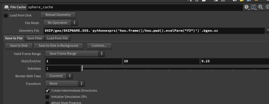

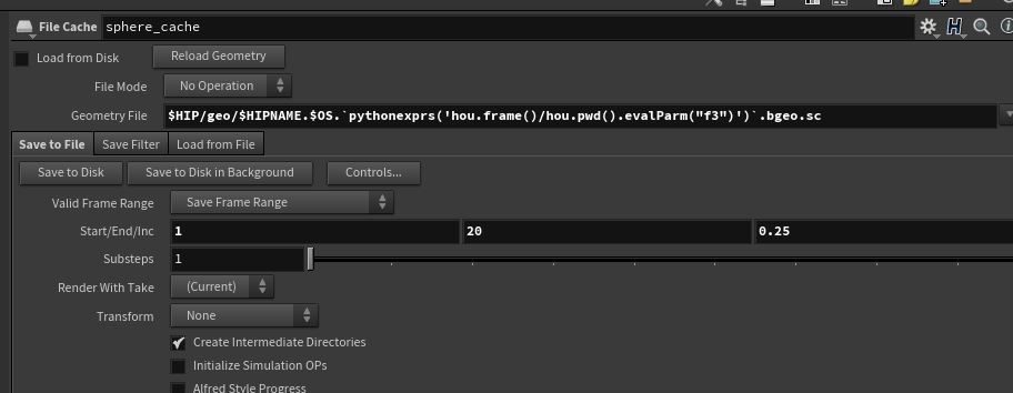

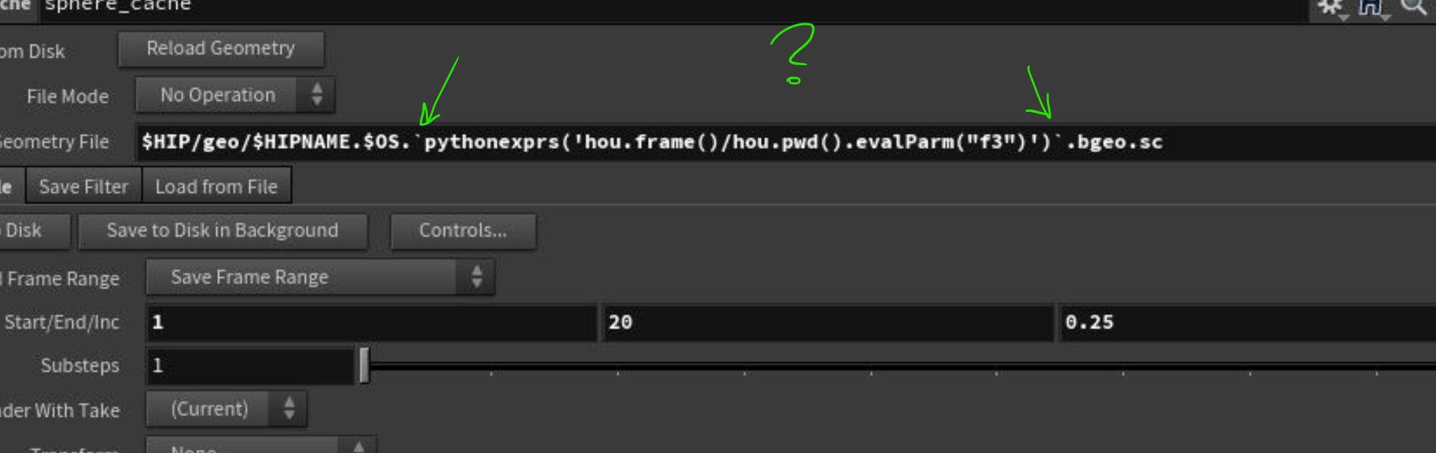

I think I'm missing something in the frame numbers,
houdini cant read this sequence back,
I'm not sure how to add padding to this expression,
so it will read correctly.
smoke.001
smoke.002
etc.
this is the text I copied from here:
$HIP/geo//$HIPNAME.$OS.`pythonexprs('hou.frame()/hou.pwd().evalParm("f3")')`.bgeo.sc
thanks!

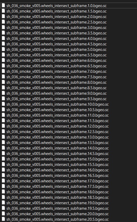

The new File Cache SOP is supposed to handle subframes properly for read and writes.

- animatrix_
- 5321 posts
- Joined: Feb. 2012
What node is that?
File Cache SOP handles file paths automatically by default:
