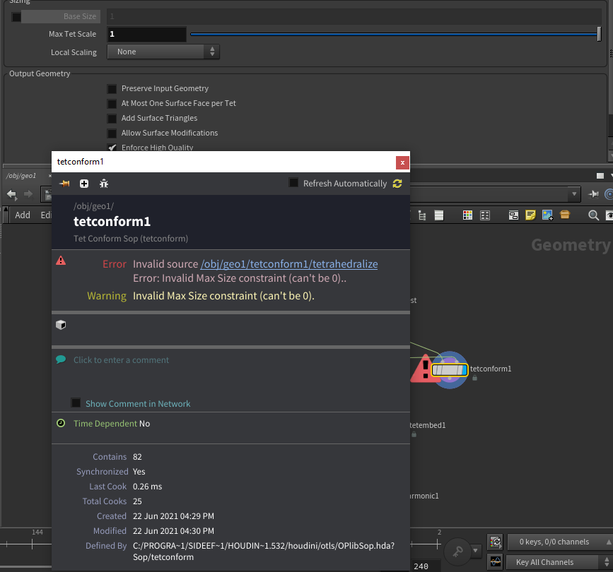

I'm experimenting with KineFx for the first time but I'm having trouble getting through the setup. I was hoping to find some more understanding here. I'm following the above tutorial, and I'm around 18-19 minutes in. Tetembed works as it should but tetconform creates a completely triangulated geo.
It only works if I enable 'base size' in the tetconform node, if I don't I get the following error
I feel there's something wrong with the FBX file, I made it in Zbrush and I checked it multiple times in C4D to see if there was anything going on I couldn't see in Houdini but it seems like it should just work fine.
Invalid source /obj/geo1/tetconform1/tetrahedralize
Error: Invalid Max Size constraint (can't be 0)..

Hey, you are trying to capture packed geo.
First unpack it and then capture

Thank you... this problem was driving me crazy for quite a while... Unpack solved it for me.
