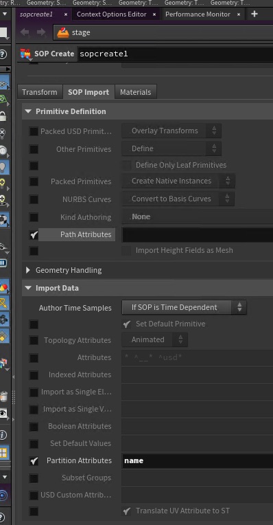

Adding to my findings…
On the SOP Create LOP I enable and clear the path attributes field in the Primitive Definition section.
The below in the Import Data section I set the Partion attribute to name.
This get's me a mesh_0 with geoSubsets. However, the subsets names are composed of the attribte name and it's value.
Please see the images, as I'm struggling to explain this any better.
Thank you all.
Thank you all.
Edited by Andy_23 - Sept. 22, 2021 15:18:38

Andy_23
I think that's how it works. It's meant for partitioning with shop_materialpath. If you partition with 'subset groups' instead, then the subsets are named directly from the groups.
Andy_23
One more thing. Is there a propre way of loading a .bgeo in Solaris have it be a single mesh and create geoSubcomponents from @name oder @path?
If the bgeo is saved with detail attributes from the usdconfigure sop, the import controls can be baked into the bgeo file to allow for configuring the direct layering of bgeo files.
