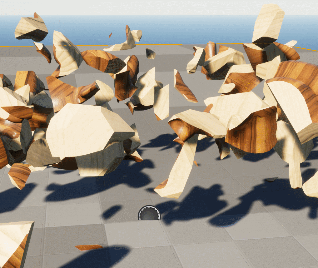

I am using VAT 3.0 to export a RBD sim to Unreal 4.25. The provided material functions from any release of SideFXLabs 18.0, 18.5 and up don't seem to work in 4.25, despite that there are material functions provided for this version of Unreal.
The vertex position seems to be read correctly, but the WPO breaks when the vertex rotation is added in the material function.
This results in a incorrect result compared to the simulation.
I've tried nearly all material functions and versions of VAT in releases that I could find (HoudiniEngine github, SideFXLabs github) etc but am making no progress. Are there some pointers as to what version of Labs as well as Houdini FX I should use for 4.25?

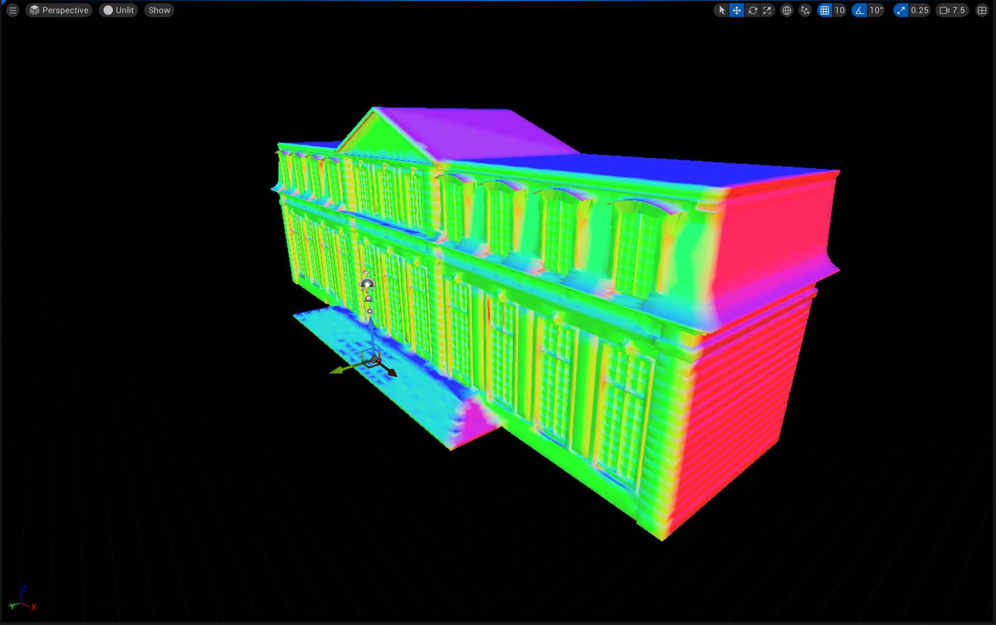

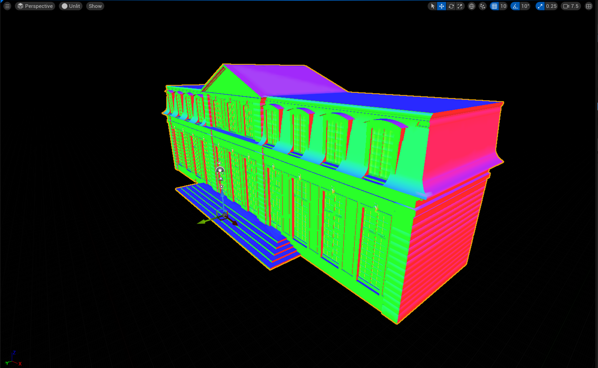

Hi i also have a problem with the normals (Unreal), there is some kind of interpolation going on:
For both i just output the WSVertexNormals inside the BaseColor, VAT works great otherwise.
First one is using a ROP FBX second one is the fbx outputed by the LABS VAT.
Edited by LaurentNovac - Nov. 2, 2023 07:30:30
