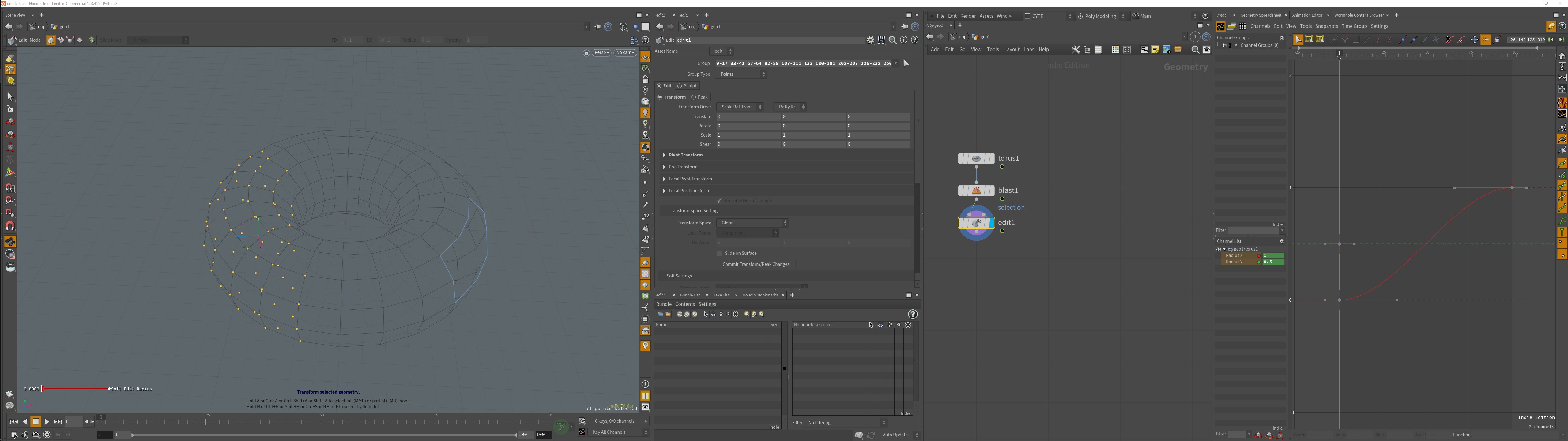

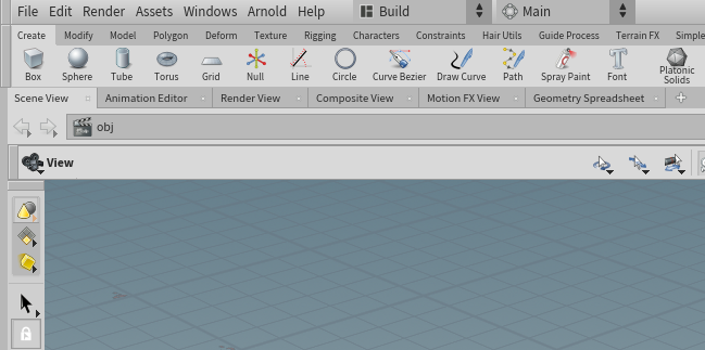

Hey Everybody,
I thought it might be a good idea to share Houdini Color Schemes. So I share a theme I call MODINI as it is ínspired by Modo.
simply place both files in your Houdini User folder/config folder and switch the color scheme to MODINI under color settings. Also, switch to the grey background under Display settings.
Cheers
CYTE

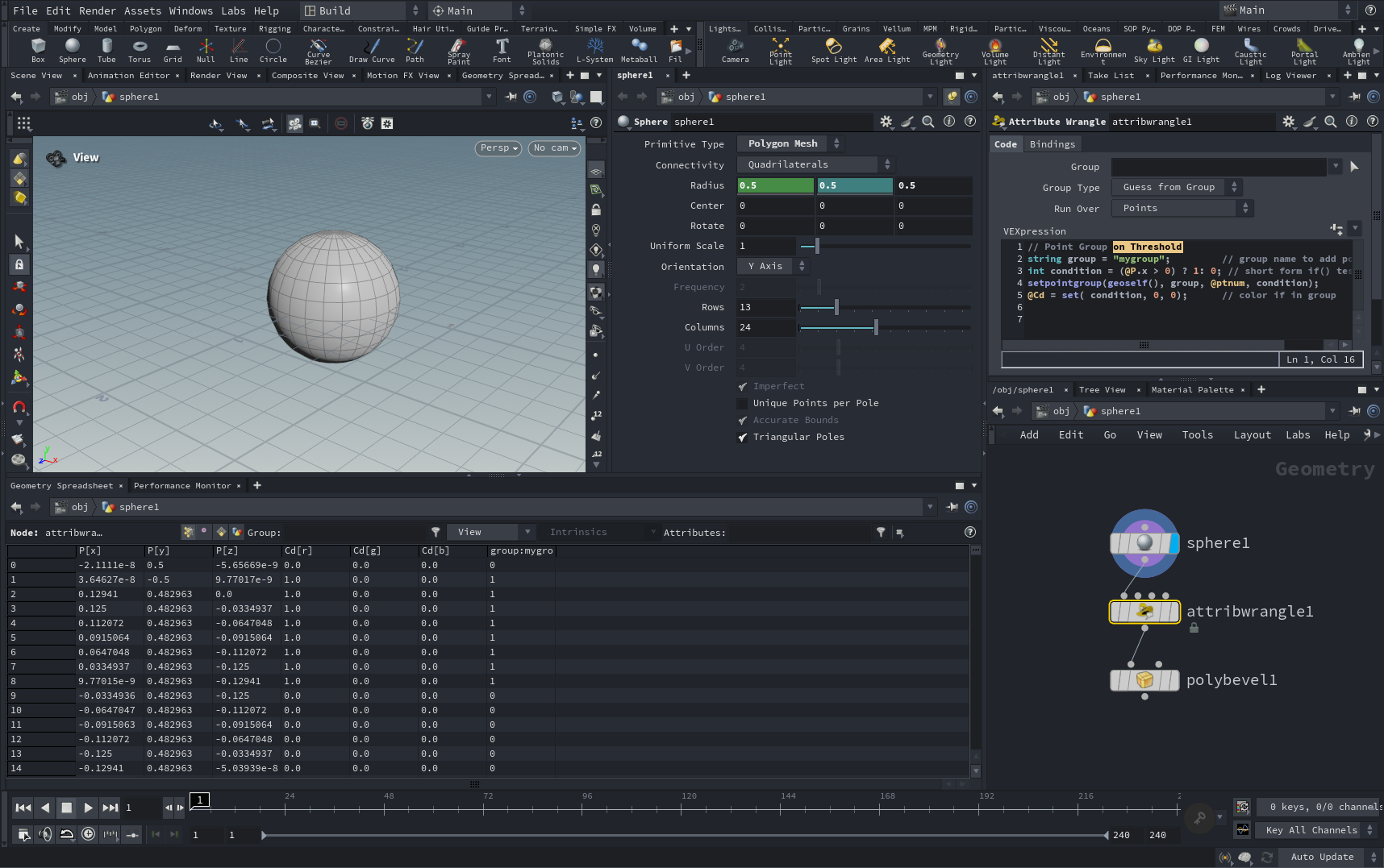

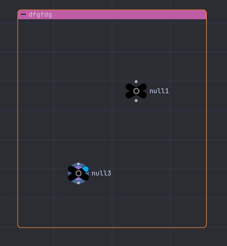

Here it is my version of the above shared "UIDarkFlat" theme by quryo combined with one of the oldest Houdini flat theme, the "Slate", and I call it "EtanFX".
Of course I recolored the whole and also added comments for the most relevant parts of the scheme to find and identify them more easily (here are a few screenshot) and I really thank you guys for sharing your very aesthetic Houdini themes!
(Updated)

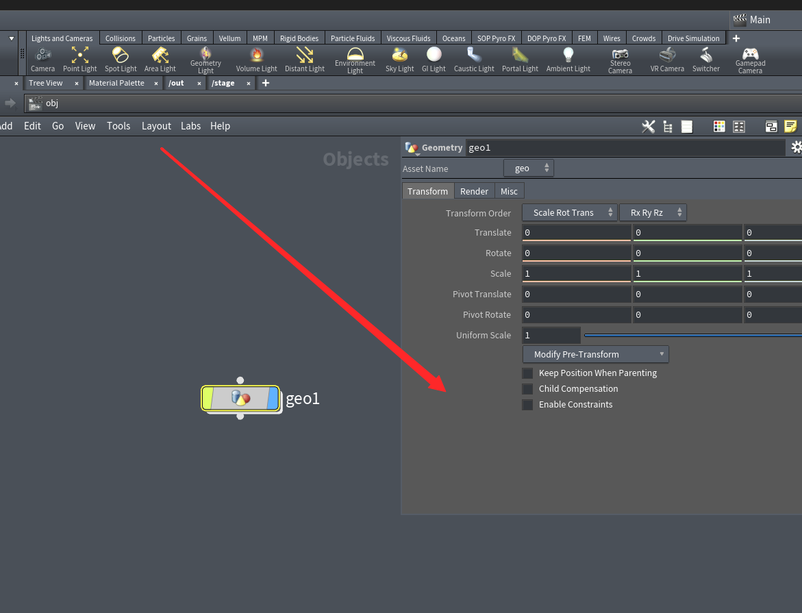

@belala
Hey! Very nice theme. The only critique I have is that the sliders' indigo color is a bit jarring and the active tab of the parameters window seems "inverted" and found myself confused a few times (darker gray seems more appropriate to inactive tab).
I'm going to hunt down these to change them, but until I do that, for time saving sake, can you please tell me which line/s are controlling these?
Thanks!
Thanks!

@citizen
Hi, you are lucky, after half an hour to track down those lines I finally found the necessary strings, you can use these new color codes or any others you like. Cheers!
SliderTopBorder: DRKBASE // slider border
SliderBottomBorder: DRKBASE // slider border
GroupHeaderHi0: DRKMID2 // active tab lower over
GroupHeaderHiTop0: DRKMID2 // active tab upper over
GroupHeaderOpen0: DRKMID2 // active tab lower
GroupHeaderOpenTop0: DRKMID2 // active tab upper
ButtonNonActiveGradLow: DRKBASE // inactive tab lower

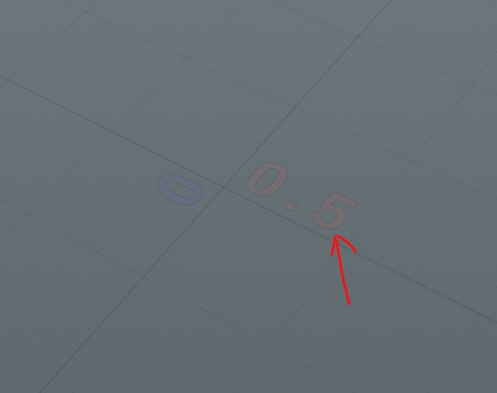

Hey,
does anybody know where to change the color/alpha of the ruler numbers?
Cheers
CYTE
edit: Nevermind found it. If anybody is wondering. add these lines to your color config file:
GridXRulerColor: 1 1 1 # reference grid x ruler color
GridYRulerColor: 1 1 1 # reference grid y ruler color
GridZRulerColor: 1 1 1 # reference grid z ruler color
GridLineAlpha: ALPHA 1 # alpha of ref plane grid lines
