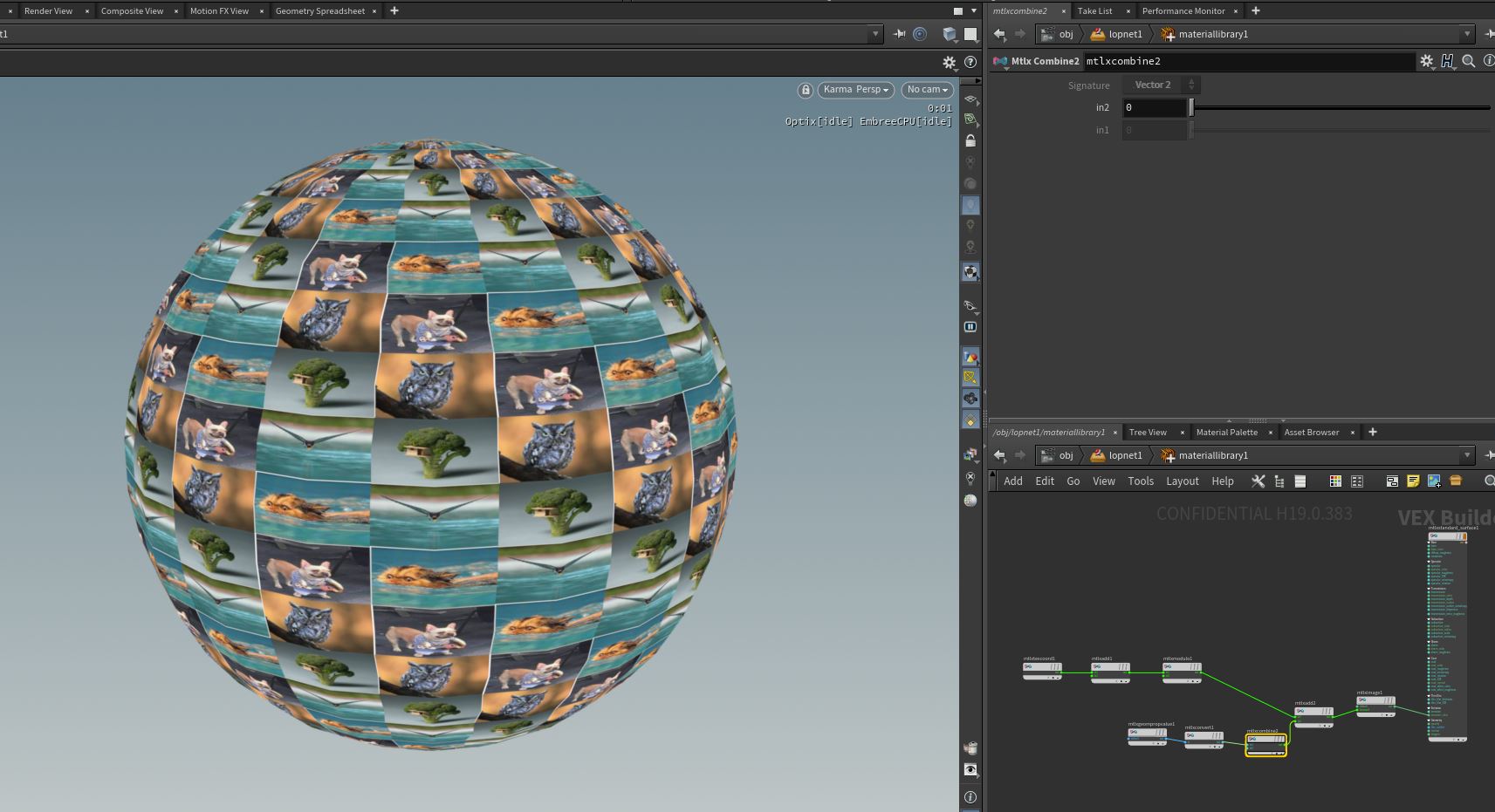

I've thought a little more about accessing different textures procedurally on XPU in MaterialX.
Two workarounds exist
1) Use a switch node
So if you had (eg)5 textures, you could simply feed all 5 textures into a switch node, and then drive the selected parameter with an integer primvar.
This does not scale very well, and will slow down with large amounts of textures (especially on CPU device), but its an option
2) Use UDIMs
So udims allow you to specify a grid of textures and then access them procedurally within the shader.
Simply add the integer coordinates of the grid location to your 0->1 UV coordinate to access what texture you want
Attached is an example of both being used
proc_texture_xpu.zip (109.8 KB)
