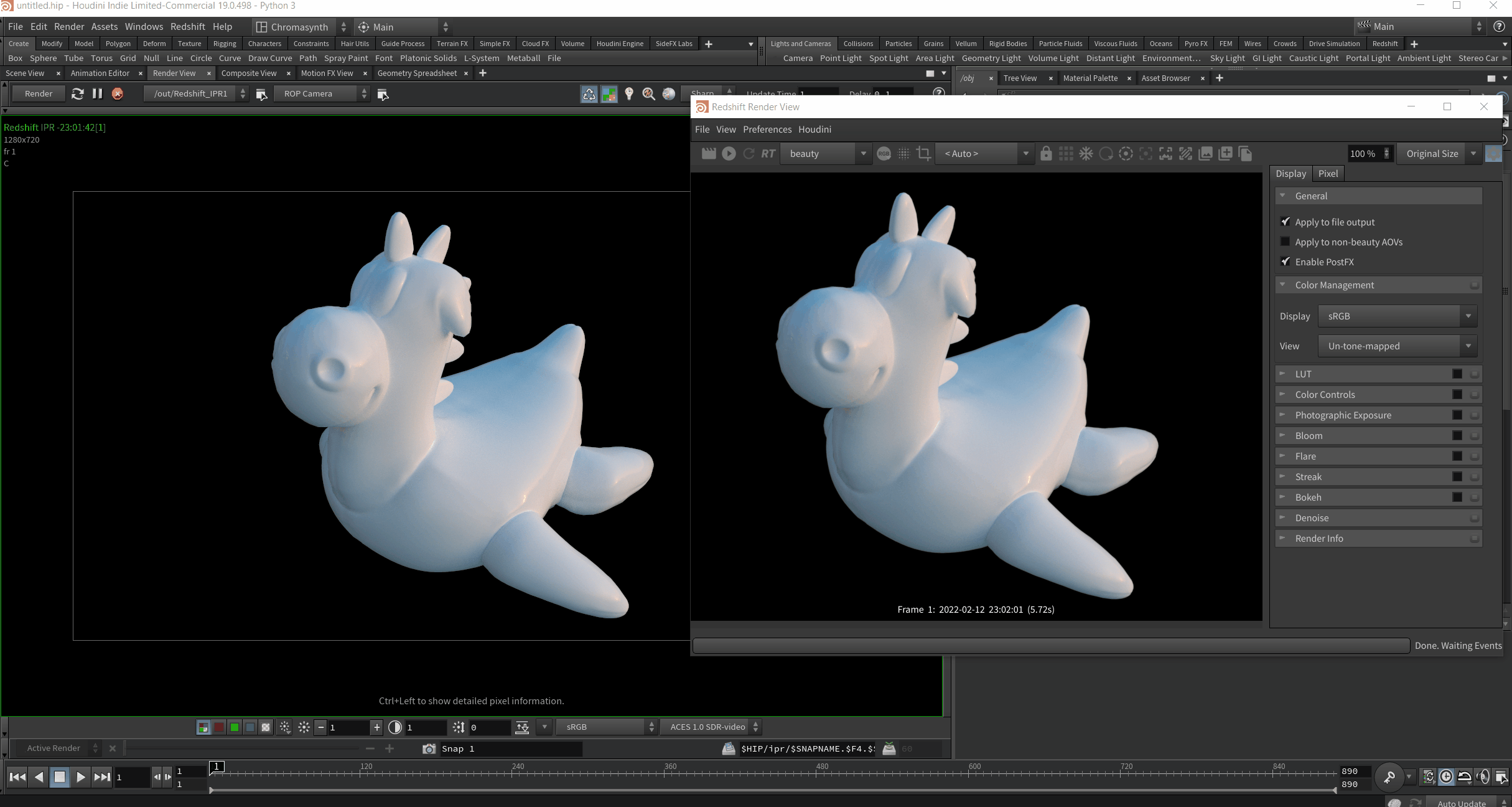

Sent to support but amplifying for visibility here. ACES 2.0 is broken in Houdini (and Mplay) - it appears there a double transform in the viewers when using OCIO. This has been confirmed by the Redshift devs.
Is there a fix coming soon?
thanks

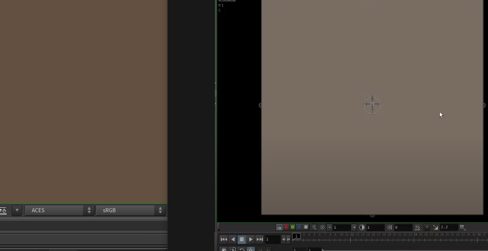

Is that the reason a color looks different on my setup than it does in a tutorial video, even though I'm using the exact same RGB values as the author? I was thinking it was because of YouTube conversions, but maybe not. Here's a screen shot comparing my setup and the video (video is on the right).

Your screen shots show two different color management systems in use. On the left, an OCIO config (most likely an ocio v1 config), and unmanaged color with 2.2 viewing gamma. The difference in view transforms is what causes a difference in appearance.

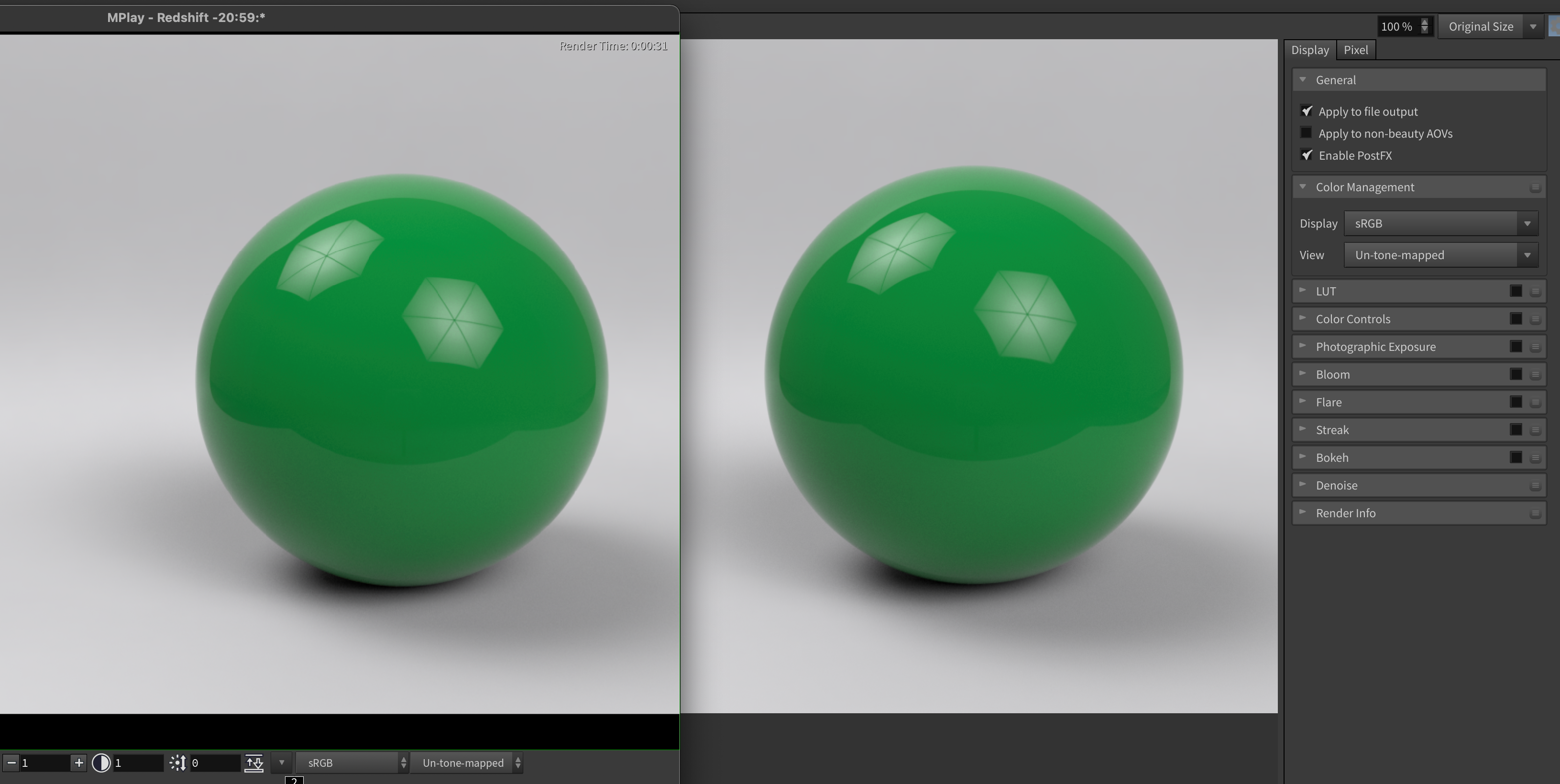

I'm not super up on ACES, but when using the Redshift provided config.ocio with Houdini, MPlay doesn't seem to work with it.
The Redshift Render View seems fine.
Unsure if it's directly related, but here's what I see with Houdini 19.0.498:

It's a 2.0 config. Houdini seems to support 2.0 configs partially, but builtin tone maps appear to be not functional. Basic gamma transforms such as part of the piecewise sRGB EOTF are totally wrong too, showing a very mushy curve toe, as if some kind of low res lut is being used instead of an actually piecewise gamma function.
I would stick with a 1.0 config such as aces 1.2 or 1.0.3 from the Academy.

Have been playing a bit with the Maya OCIOv2 config in Houdini and Redshift. It seems with this config MPlay matches the RS render view quite well apart from the tone mapping view transform. So with display set to sRGB and view to Un-tone-mapped, they match, with view set to ACES 1.0 SDR video, the Redshift render view clearly tone maps the image, MPlay doesn't do a thing. The log and raw views do work in Mplay.
In the OCIO config, the ACES 1.0 SDR video tone map is using a builtInTransform with a style setting. It seems this is not working correctly with MPlay.
After working this out with the Maya config, I tried the Redshift config as well, and this seems to give the same results.
Tried it in Maya as well. The Maya render view is behaving the same as the Redshift render view, so it's definitely Houdini/MPlay behaving differently.
Attached two screenshots for the comparison.
