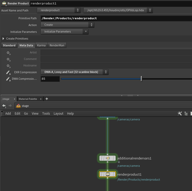

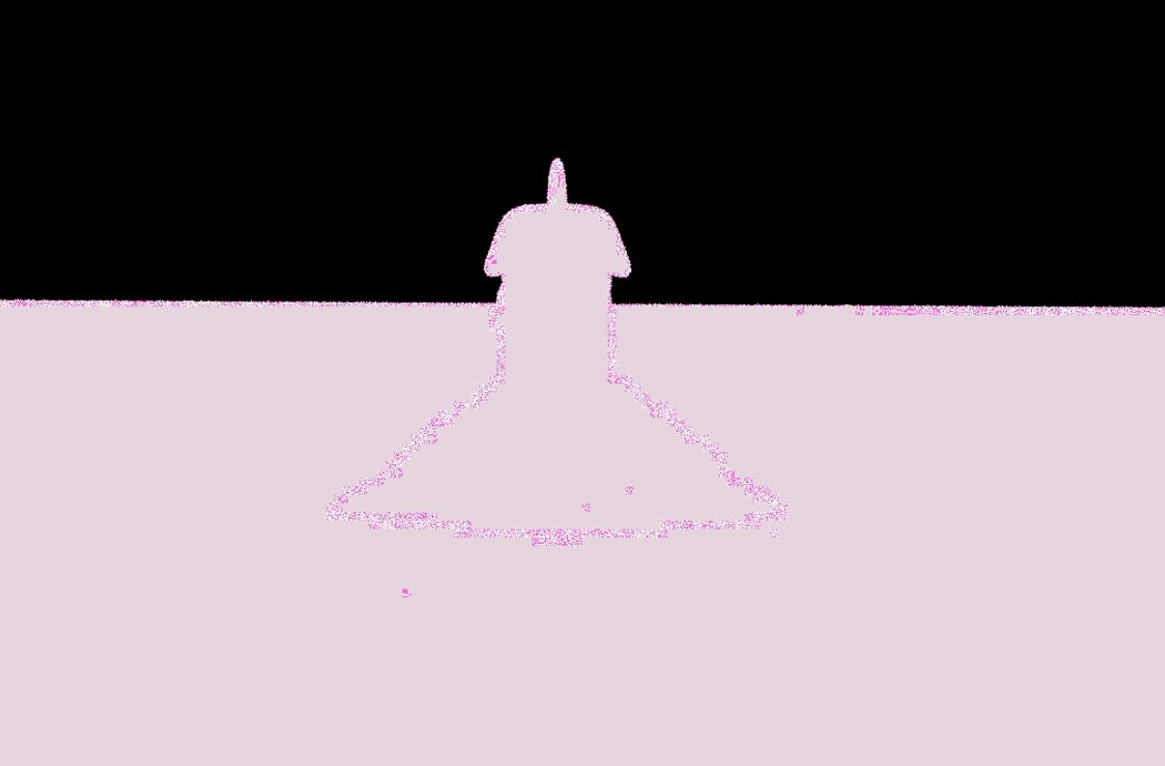

We are using dwaa as compression method on the renderproduct but it breaks the cryptomatte in karma. Is it possible to make some rendervars to be lossless?

Are you rendering to the same product? Use a different product to control different image format features.

I had the same thought but when i use usd_render_rop it only picks up the latest renderproduct in the rendersettings list. I just assumed this doesnt work but now when you mentioned it I do get the output from all the renderproducts in the viewport, just not when rendering through husk. I could be doing something wrong too.

I tested out your scene and I think it comes down to the "Override Output Image" being set on the usdrender node - which will override the path for both renderproducts so they do both get written to disc, but the latter overwrites the former.
If I leave that parameter blank and instead set the path on the renderproducts I get both outputs. However - like in your screenshot above - the crypto passes are bugged in nuke.
