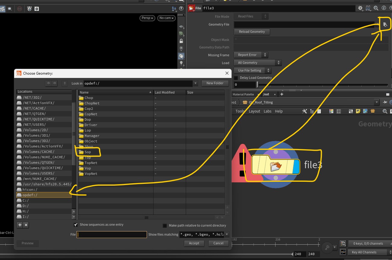

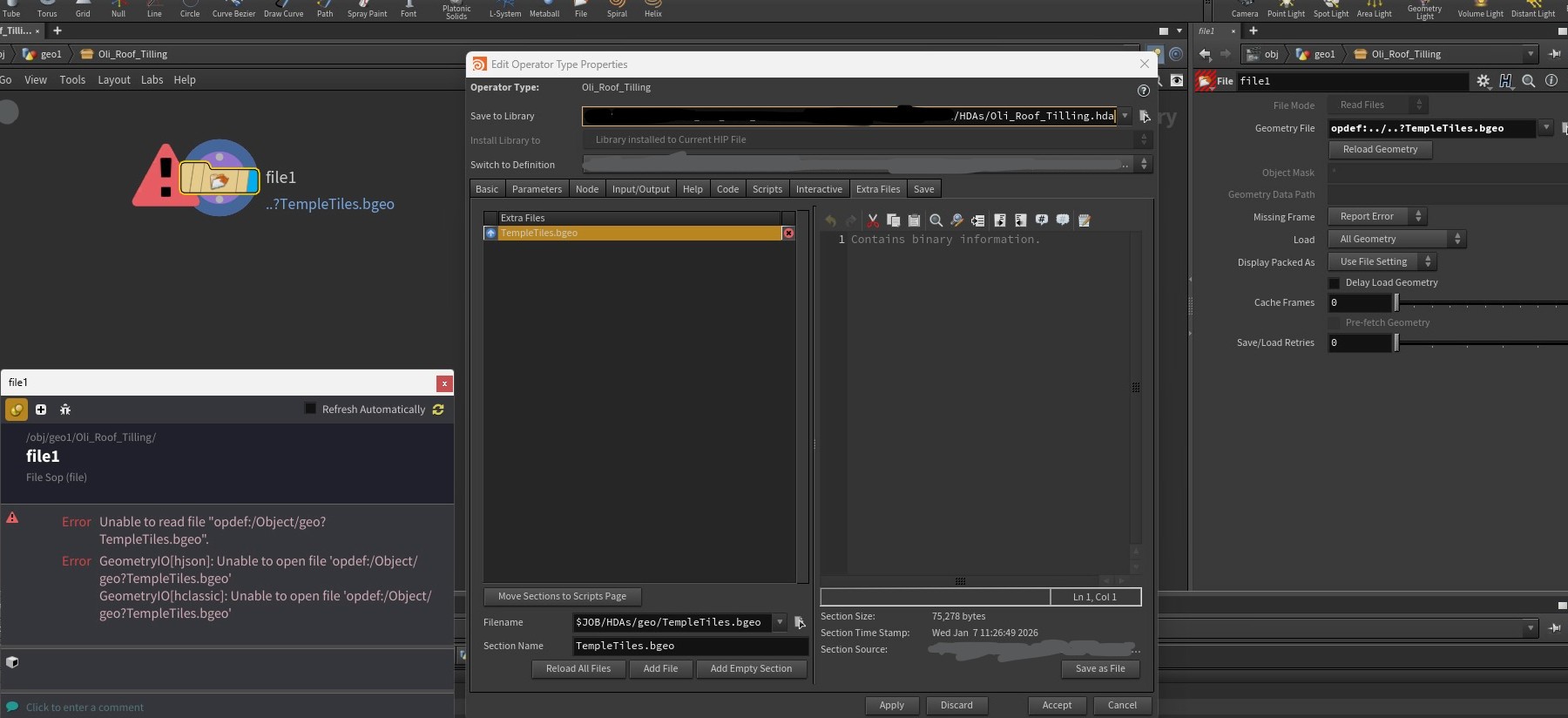

For anybody doing this, when you add the geo files (Type Properties -> Extra Files -> Add File), it acctually copies the file to a Houdini folder. (installion folders, maybe, not sure...)
When you want to replace the file path in your HDA to the new copied file I just talked about, you should do it from the File sop browser by clicking on the opdef:/ shortcut (on the left side). If your HDA was created at SOP level, browse inside the Sop folder. You should find a folder with the exact name of your HDA. That's where you'll find the file!
EDIT: My method gives me this:opdef:/Sop/Oli_Roof_Tilling?TempleTiles.bgeo but I was told to use opdef:..?TempleTiles.bgeo instead.
You can follow the tutorial EZiniT talked about here. Its in the section 8 (Create Capture Rig Digital Asset) at the 5 minute mark.
