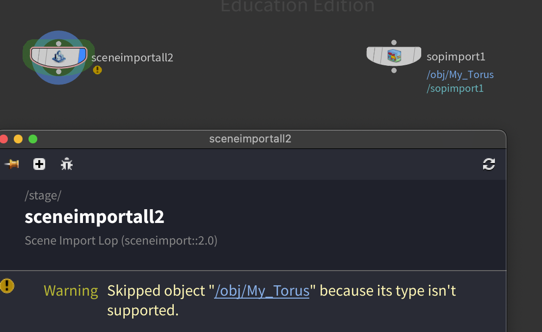

in our planetarium production pipeline, we have a number of HDAs we developed. They work in our /obj context using Mantra.
For e.g. we have a globe (planet) HDA that uses DEM and satellite visual data.
We want to be able to add LOPS/Karma to our Houdini workflow.
However, when I try to Scene Import (All) our custom HDAs from /obj into /stage, we get the warning: Skipped Object "..." because its type isn't supported.
I have attached a simplified example.
In my example, I created a geo node in /obj with a torus sop. Then converted this into a simple HDA called my_torus.
When I create a Scene Import (All) LOP, I get the above warning.
As a workaround, I try to import my HDA using an SOP Import LOP. Which works, but then it loses the transform inherited by the null hierarchy in the source /obj context.
What am I missing?
Thanks

For custom object types you may have to create your own translator plugin
https://www.sidefx.com/docs/houdini/hom/sceneimport_object_translator.html [www.sidefx.com]

Here's the simplest translator:
import husd class TorusTranslator(husd.objtranslator.Translator): def shouldTranslateNode(self): return True def primType(self): return 'Xform' def registerTranslators(manager): manager.registerTranslator('my_torus', TorusTranslator)
You can rapidly increase the complexity if you want to start handling custom attributes, visibility, etc. Specifically regarding visibility, it's on my todo list to add an additional translator base class (something like husd.objtranslator.VisibleTranslator) so that the logic for handling the obj-level visibility flag can be more centralised.

Hi Rob,
I created a file called my_torus.py with the bare-bones code you provided.
See attached.
I'm currently testing on macOS BigSur, so I put this file here:
That worked!
Thanks again.
See attached.
/Applications/Houdini/Houdini19.0.561/Frameworks/Houdini.framework/Versions/Current/Resources/houdini/husdplugins/objtranslators/
That worked!
