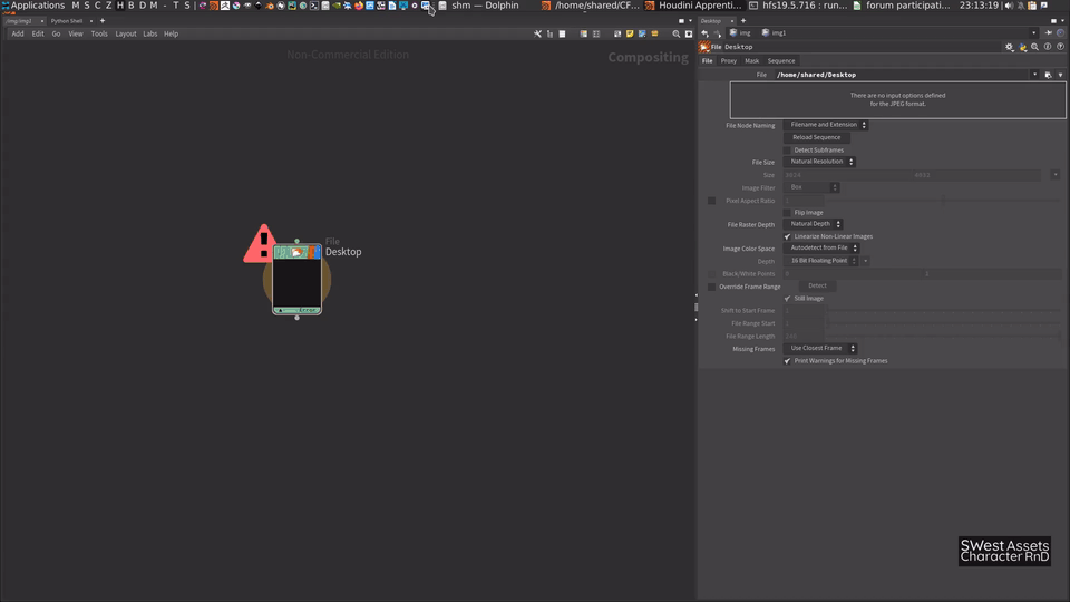

1) This first case is a repeatable state. The initial folder set has many files and this will cause a delay before the window is open. The same delay occur when navigating to that same folder. Thumbnails are hidden but opening the folder is still slow on the nvme (m2/PCIE) storage medium.
2) The second case is that Houdini can be in a "negative" state, for unknown reason, that causes the file browser to have extreme delay (appx 2 min). A work around for this state is to restart Houdini, so the source is not the system itself. This bug is challenging to remove because it is unclear what causes this state. During my tests this only happened once, and during the first test. This severe state I could not reproduce.

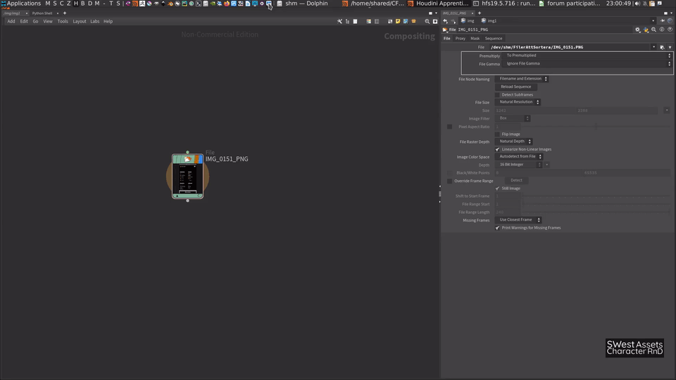

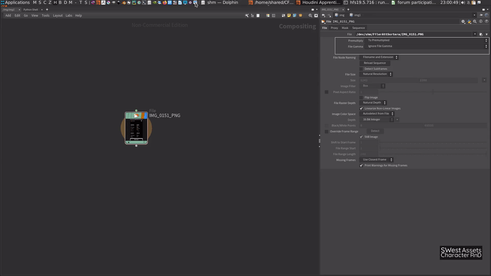

3) To do some more comparison, because this is a tricky case, I copied the same folder to a ramdisk. Now there is no delay whatsoever. However, now this is true only when the thumbnails are hidden. With thumbnails visible it is still slow. See output2.gif.

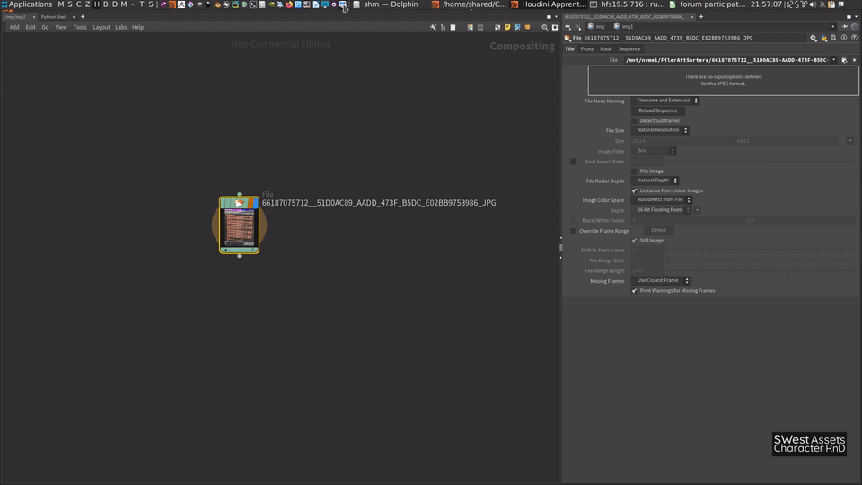

4) Also to compare some more I copied the same folder to my RAID (quad SSD:s in maximum performance mode). The window open instantly when thumbnails are hidden. However, with the thumbnails displayed it is quite slow.
