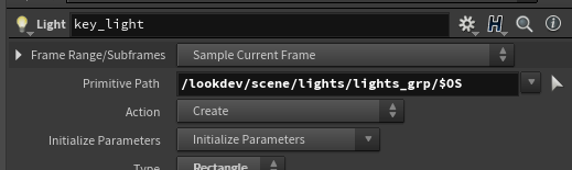

I was using relative paths on the lights' primitive path parameter (I left off the forward slash at the beginning), but once I changed it to absolute path the lights started to behave as expected. Any idea why this behavior? because when I left off the forward slash, the light still ended up in the correct part of the hierarchy in the scene graph. What is the major difference between the relative vs absolute path here?
I didn't think there was such a thing as relative paths. Perhaps one part of the code is sanitizing the input by adding the slash, and another part, the handle, was using it as is--therefore unable to locate the prim.

There are no relative USD prim paths, don't confuse node paths and USD primitive paths, these have no relationship to one another. I guess you can think of LOP nodes' primitive pattern parms more like the group parm on SOP nodes - they allow you to specify on what subset of the underlying USD data the nodes should operate on.

ahh, I see, this is what @jsmack was saying. I get that now.

This sounds like a bug that malformed input is handled differently depending on the code path.
