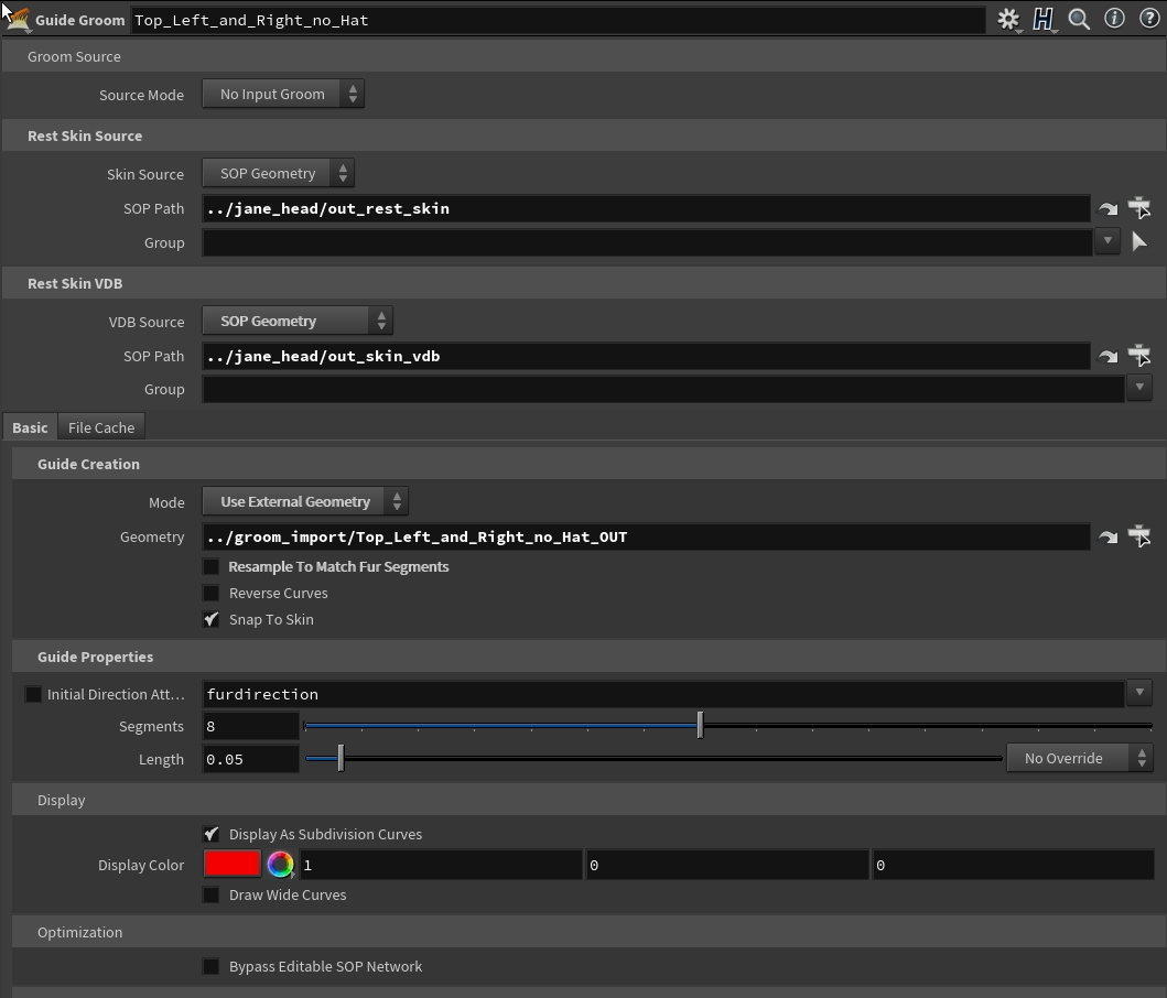

My Houdini scene file got over 5GB from just importing a couple of alembic groom assets, resampling them and feeding them into/working with the groom and hair objects.
Saving takes forever, like 10 minutes as of now, and file size is 5.8GB
I tried to put all the input files in a filecache and deleting alembic nodes, but this changed nothing.
Is there some setting I need to change?
Thanks!
obj context.jpg (85.2 KB)
guide groom.jpg (189.1 KB)
hair generate.jpg (215.3 KB)

Did you do any grooming with guide groom? that node saves a copy of the modified groom.

It was definitely the guide groom node. As soon as I changed a single hair the filesize would skyrocket.

as mentioned Guide Groom SOP saves a copy of the whole groom as soon as you touch it since edits can be destructive
so to avoid having each groom saved into hip file avoid using Guide Groom SOP if all you are doing is just resampling, use Resample SOP, or any other procedural node to modify curves the way you want
Guide Groom Object should be fine though and it offers resampling, are you experiencing issues with that node also?
