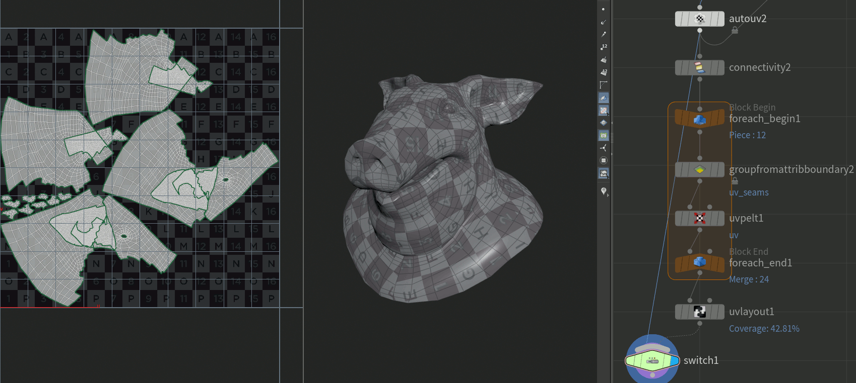

You can try taking advantage of UV Pelt SOP and skin each UV island in a foreach loop. In theory, pelting should never create overlaps, but don't expect decent UVs coming out of it.
662 posts
Joined: Aug. 2014
Here's a demo scene which I didn't have time to post earlier.
uv_pelt.hipnc.tar.gz (34.6 KB)

Thanks! I'll check it. I tried pelt before but i couldn't use the results as those were not decent for a game.
