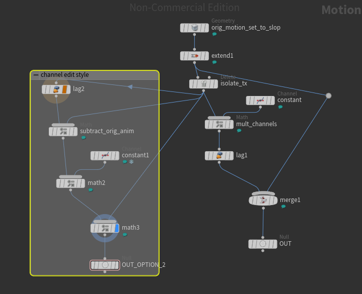

Here is a more procedural way. Please middle click on the nodes for explanation.
  • Take orig anim make sure to use extend options to interpolate slope.
  • Create a single channel with a constant value of 1 which starts well before the scene.
  • Mult the orig channel with this
  • You have to do this to "harden" the slope created by extending it via the extend CHOP. Otherwise the lag CHOP doesn't see the extended channel.
  • Your lag will no longer jump.
I have also fleshed out yesterday's suggestion... it is a bit more fiddly, but it's a good technique to know.
The only reason I know all this stuff is because I used CHOPs a lot in the early 2000s on a kid's TV show where we re-used a lot of motion clips. And CHOPs is a time-warp that hasn't really changed in over 20 years.
