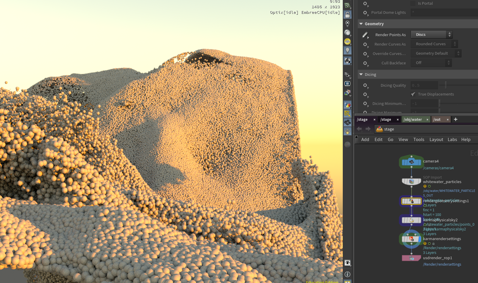

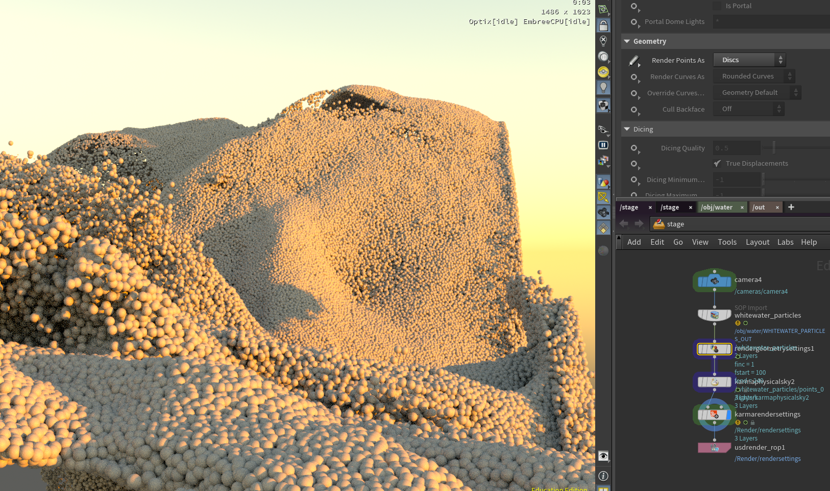

You can render discs by the way, as for instancing anything make sure you cache your instances on disk, better yet if you cache as USD there is no faster read cache than this also make sure to import pack primitives as "point instancer".

Why is it necessary to cache the instances?
The option you show for points as discs does not work in Karma XPU, unless they changed it in the last couple weeks. That only works in Karma XPU.
I'm also confused because you are talking about instancing but also showing render points as discs. You only need instancer if you can't use render points as discs.
"import pack primitives as "point instancer"" - Where is this? What does it do?
Edited by physixtential - Feb. 19, 2024 08:19:15
1067 posts
Joined: April 2008
-Why is it necessary to cache the instances?
It is not but it is always more efficient not just for instances, my suggestion for best efficiency on Solaris with USD is to have everything cached in USD before going to render specially if it is a heavy scene, doing so you wont have unnecessary extra calculations on render time and USD caches are much faster than bgeos besides other benefits.
-The option you show for points as discs does not work in Karma XPU.
It does I just showed you and for some time now.
-I'm also confused because you are talking about instancing but also showing render points as discs.
I am not instancing anything it is just points rendered in XPU as discs
-"import pack primitives as "point instancer" - Where is this? What does it do?
It makes Solaris see your packed as real instances on points so it is much more efficient than have USD native instances that is a kind of different concept, so if your objects are blue on the graph tree they are individual instanced objects not point instances, I hope that makes sense.
Summarizing: native instance != point instancer.
Edited by mzigaib - Feb. 19, 2024 16:19:52

Points as discs is not supported by XPU--it's not possible with the way the ray tracing engine works to have discs that always face the incoming ray. I could see oriented discs being supported but not camera/ray facing discs.

You can happily set points as discs, but it won't do it.

In the geometry settings LOP node are you pointing to the right primitive?
Yes. For example, they all get motion blur if I set motion blur on the very same geometry settings. Discs just simply don't work in xpu. I think you are using cpu.

regarding disks, XPU cannot render points as disks but we plan to add this capability soon.
Hopefully we can get view-facing as well as oriented. It is conceptually possible to orient the disk to be facing the incoming ray, but I'm not sure what happens with things like reflection or shadow rays. Some hackery might be needed in that regard.
Yes you are correct I was using CPU my mistake.
But instancing circles on points should not be that heavy try to use point instancer.
