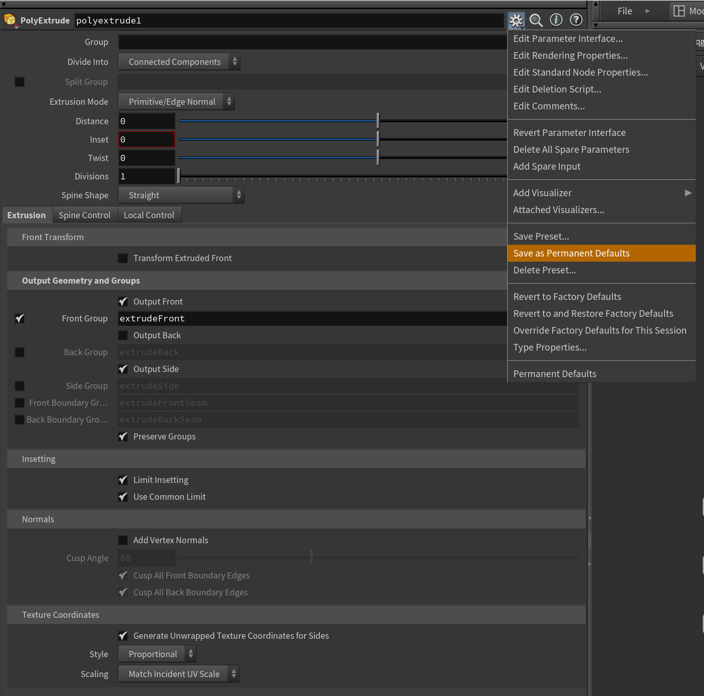

The question is essentially - how can I make it so that polyextrud is called up by hotkey indicating "extrudefront" in the groups?

Not quite what I wanted. This will help in the node tree. But I would like the extrudes called using the Q hotkey or another in the viewport to work with the same group, if it is specified - extrudefront or frontSeam. But since the frontseam group is broken in current versions, let at least extrudefront be used. If I need to, I will interrupt or change this chain, but in 90% of cases I am happy with using the extrudefront group by default. You can save the checkbox for activating the extrudeFront group as default, but the selection of the group in the first line is not saved (for the viewport). And selecting a node from the shelf or calling via Q or calling via a custom hotkey fills the group with the polygon number, and not the extrudefront name.
The fastest thing I found was to click on the gear each time and load a saved preset called extrudeFront. Or drag it from the shelf to the network, then the default settings will work. Here are our “punch cards” peeking out. Perhaps can write some kind of script so that all this is filled out correctly, but I don’t know how to do it.

You can do it, but to do it "seamlessly" (a.k.a. just like native Houdini way) you will probably need to dive into soptoolutils. Unfortunately it's not documented...

is this what you need?
group = "extrudeFront"
viewer = hou.ui.paneTabOfType(hou.paneTabType.SceneViewer)
cur_node = viewer.currentNode()
if cur_node.type().category() == hou.sopNodeTypeCategory():
    extrude = cur_node.createOutputNode("polyextrude")
    extrude.setParms({ "group": group, "outputfrontgrp": True, "frontgrp": group })
    extrude.setDisplayFlag(True)
    extrude.setRenderFlag(True)
    extrude.setHighlightFlag(True)
    extrude.setCurrent(True, True)
    viewer.enterCurrentNodeState()

But where to enter this code?

Well... wherever you can put python code.
For example, make it as a shelf tool.
