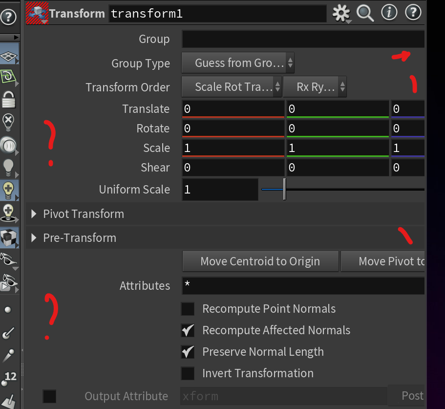

What's this space for? It seems really unnecessary for multiparms to take so much space. Is there a more "compact" UI?
Why do multiparms waste so much screen space? Why so wide?

A couple of tricks to reclaim some precious space in the parameter panel:
1) Nest the multiparm folder inside another folder. Set the multiparm folder to hidden. This way you get rid of the buttons for adding and clearing each instance.
2) If you need to force all way to the left any parameter, just insert a dummy parameter before (I usually use a label parm), set it to invisible and join it horizontally to the next parameter you want to move to the left.
