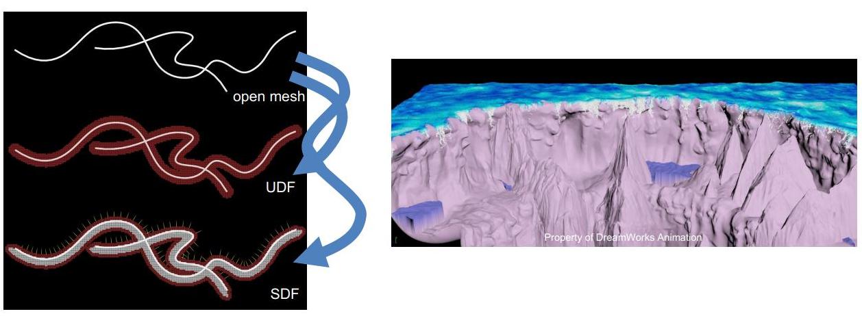

In production, we get open surfaces from Modeling often. The common practice is to convert the mesh to an unsigned distance field prior to converting to a signed distance field.
I have an example in the Houdini example file https://www.openvdb.org/download/ [www.openvdb.org] Look for /obj/example_levelset/extruded_sdf
