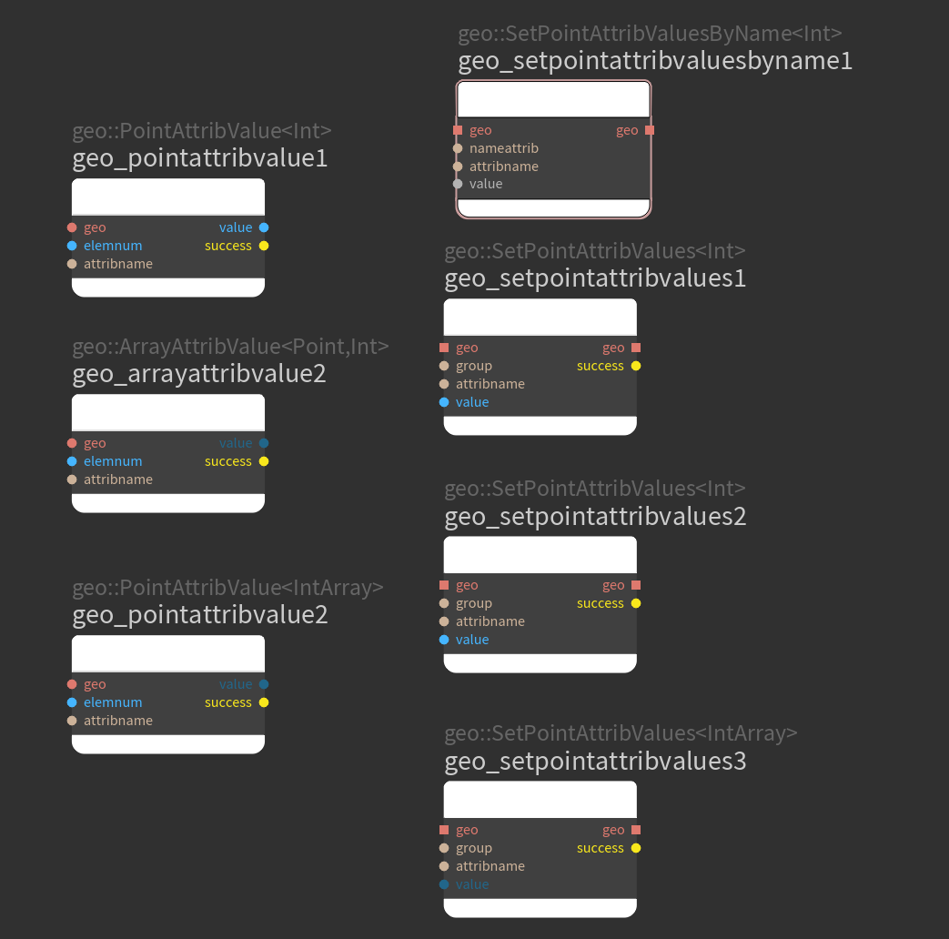

Could somebody also shed some light on the "intended" way to set attrib values on a whole load of points?
I see that according to the docs, setpointattribvalues is supposed to set an attrib value on all points and take an array as an input. But the node itself in Houdini doesn't take an array as an argument. https://www.sidefx.com/docs/houdini20.5/nodes/apex/geo--SetPointAttribValues.html [www.sidefx.com]
I also cannot see a corresponding getpointattribvalues.
In theory, would this method be faster than using setpointattribvalue and running it in a loop over all points?
- kodra
- 373 posts
- Joined: June 2023
I'm by no mean an APEX expert, but I don't think geo::SetPointAttribValues can do what you describe. It sets all points' attributes to the same value. For the same reason there is no get version.
SetPointAttribValuesByName kinda does it, but you need to have an index attribute first (e.g. Enumerate SOP with string type) and it takes a variadic input instead of an array, so it's still less than ideal...

So, geo::SetPointAttribValue sets the value of a single attrib on a single point, and geo:setpointattribvalues sets an attribute across a whole load of points?
I may be misunderstanding, but geo::SetPointAttribValue is quite slow for large point numbers no, since it means the geometry needs to be updated repeatedly in a loop?
If there was a way to set an attribute across all of the points at once wouldn't this be more optimal, since it only needs to update the geo once?
The utility of geo::setpointattribvalues seems very limited, because you are limited to setting all points to the same attribvalue, which is rarely needed. It seems like it would be more useful to be able feed an array, where the array index corresponds to the point number that is being set? The docs seem to describe this functionality.

I can't speak to how apex works under the hood, and i'm sure that many of my assumptions/ideas are unfounded, since admittedly, I am coming from vex/sops and trying to understand this new context. buuuuut...
It's very easy to prove that geo::setpointvalues is able to set attributes on all points on a geometry *much faster* than using geo::setpointvalue inside of a loop. The difference in cost becomes quite huge when applied to lots of points, or when this is done many times.
But the limitation that all points need to take the same value kind of nullifies setpointattribvalues to very niche use cases. I'm unsure why it has this limitation, if its intended, if sidefx are aware of this, if its an issue/mistake, or if there's another intended way to set different values on different points that maintains speed.
