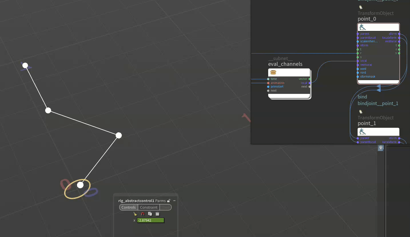

Hi, This is a little more advanced. But you can use channel prims to drive the animation.
Edited by william_harley - 2025年10月13日 10:23:42
Screencast from 2025-10-13 16-15-09.mp4 (380.3 KB)
drivenAnimation.hip (465.1 KB)

Not at the moment, we are working on simplifying the process.

Yes, you can simply build a local matrix rather than plugging it into the r. This way you can animate on top of of the driven animation.
