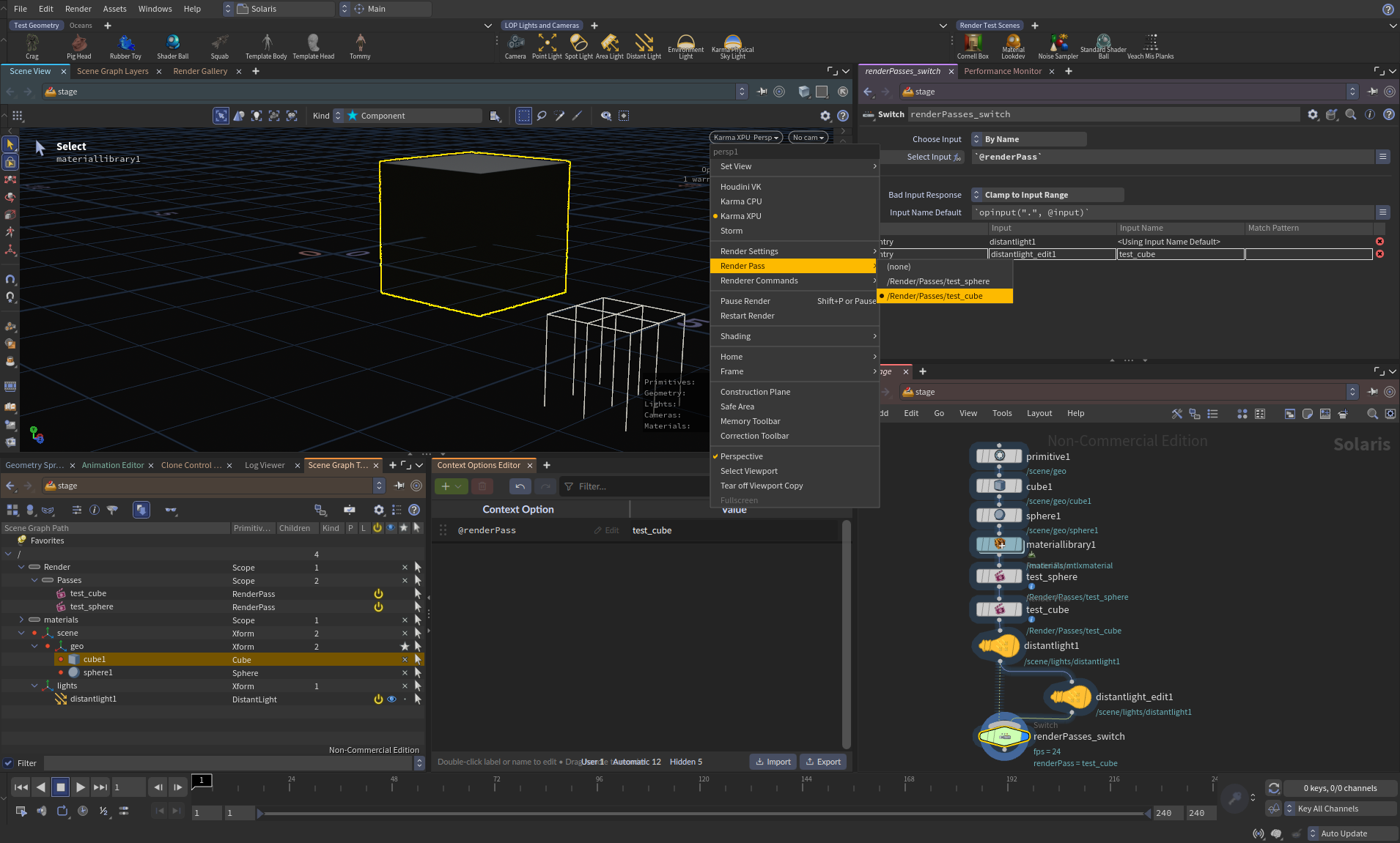

Thanks a lot for the reply. That all makes sense.
I'm pondering how an implementation with a broader scope of features would look like. Ideally I would like to make use of the USD RenderPass system, but with the limitations I suppose I have to add another layer in the form of context options on top. Use the built-in RenderPass system to handle visibilities and use context variables for any additional per-pass overrides.
Consider the following example. A simple scene with a sphere, a cube and corresponding passes. The RenderPass nodes are used to set visibilities. Now, I want to do more to a given pass than setting visibilities only. In the cube pass I want to modify the rotation of the light. For this I'd need an additional variable. (I understand that in theory I could output the pass directly without a switch, but in a multishot scenario I might want to do overrides per pass in a specific shot branch).
Now the issue with this approach is that I need to manage both the active pass and the corresponding context option:
I tried looking through the API to find a way to grab a callback or similar of the currently selected RenderPass in the viewer, but had no luck. How could one go about this? I could skip the RenderPass system entirely and create a separate pass system, but of course it'd be great to utilize what is already available.
Hope that all makes sense. Thanks in advance,
Julius
Julius
