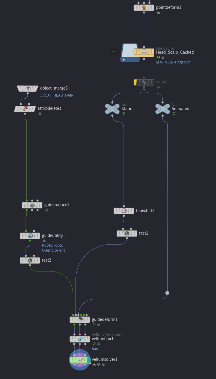

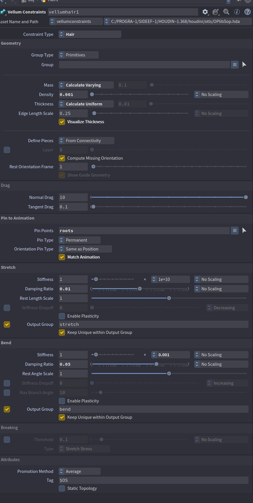

Hi everyone,
I’m currently working on a Vellum-based groom simulation and I’m running into an issue where the scalp starts moving/separating independently from the groom guides as soon as the simulation begins.
The guide groom looks correct before entering the Vellum simulation, but once I start simulating, the scalp appears to move separately while the guides no longer behave as expected.
I’ve attached screenshots of my node network along with additional screenshots showing the Vellum data at frame 0 and at the first simulated frame. From my inspection, the Vellum data appears to change between these two frames, and I suspect this is related to the issue, but I’m not sure exactly what is causing it or what part of my setup is incorrect.
The groom/guides look correct before the Vellum simulation.
At frame 0, the scalp and guide setup appear to be correctly connected.
On the very next frame, the scalp begins to move independently from the guides.
This causes the groom to separate/deform incorrectly during the simulation.
I suspect there may be an issue with the Vellum constraints, pinning, point/primitive attributes, or the way the scalp is being incorporated into the simulation.
I would really appreciate it if someone could take a look at the attached node network and Vellum data and point out what I might be missing.
Is there a specific attribute or constraint setup I should verify to ensure that the scalp remains properly attached to the guides throughout the simulation?
Thanks in advance for any help or suggestions.

I can't notice anything obviously wrong from these screenshots. Have you tried toggling on "Snap to Skin" on your Guide Utility node? If that doesn't fix it, please submit a support ticket with a file attached as it is almost impossible to troubleshoot from screenshots alone.

So there are a couple of issues with your setup.
The first I guess I could've spotted from the screenshots, but it's much easier to discover in the file, and that is that the second output of your Guide Deform should NOT be connected to the second "constraints" input of the Vellum Constraints.
The next issue relates to how you are importing your scalp geometry. When importing alembic files from third party applications such as Maya, when you unpack, you also have to toggle on "Convert Polygon Soup Primitives to Polygons". Without this it "works", but there is weird jittering in the hair.
The hair on the other hand, is coming in as NURBS Curves, which is not affected by the conversion toggle as it is not a Polygon Soup. However, the Vellum Solver cannot handle NURBS Curves, so only the roots move, while the rest of the curve stays in the rest position. To counteract this you need a Convert SOP with the default settings. However, this will lead to a very high point count on the curves and super stretchy curves when you simulate. To fix that the easiest is to add a Resample SOP and adjust the settings so that you can get the lowest resolution possible for the amount of detail that you need to preserve. The Resample SOP actually converts NURBS curves to polygons automatically, so you could skip the Convert SOP.
Alternatively, if you want to maintain the original point count of your curves, you will want to only use a Convert SOP instead of a Resample SOP, and toggle on "Interpolate Through Hulls" otherwise the conversion will create extra points. You will then need to increase the number of substeps on your solver to account for the extra resolution in order for the solver to converge and not be excessively stretchy. You'll also want to set the Thickness to "Calculate Varying" in the Vellum Constraints, so that points near one another on the same curve don't collide with one another.
Finally, you may find that points near the roots are colliding with the scalp in unwanted ways. You can use a "Group Expand" to create a new group called something like "near_roots", and set the steps to 2. Follow this with a point wrangle with this group specified in the group field and the snippet set to

Thank you both, Liesbeth and Kai, for your suggestions and for sharing your methods. They clarified a lot of things for me. However, there are still a few points that I’m not completely sure how to achieve.
First, if I don’t want the clumps to be distributed equally, how could I create a more random clump distribution? Also, is there a way to control the clump distribution using a mask or a painted attribute? This would give me more control over where the clumps are created.
Second, I tried to generate Glue Constraints using the method you suggested, but unfortunately, I’m either not applying the constraints correctly or the method does not fully support them. The Glue Constraints seem to work quite well when using the standard Houdini grooming workflow, but I’m having trouble getting the same result with this approach.
I’ve attached a file showing my setup and how I’m currently approaching the method you suggested. Hopefully, this makes it easier to understand what I’m trying to achieve.
Finally, I have one more important question. If this method works well, how would you recommend simulating and rendering millions of hairs? Simulating all the hair directly seems to require a lot of memory.
Is there a more efficient or memory-friendly workflow for handling millions of hairs while still getting a good simulation result? For example, should only a smaller number of hairs be simulated and then used to drive the rest?
Any advice or suggestions would be greatly appreciated. Thank you again for your help!

It's not working for you because you bypassed the Guide Reduce which is required to find one curve per clump. As soon as I enabled it again, the glue constraints were generated. This is on your main hairs. The result of the Guide Reduce in this case, for the clumpid generation, would only be used as an input to the Guide Deform which finds the weights for each clump curve.
The Guide Reduce should be able to detect a more random clump distribution if it exists in the incoming groom. It tries to find one curve to best describe all the surrounding curves, and it isn't density based - it is just based on the Target Guide Count parameter. However, you can make use of the Density Mask override on the Guide Reduce to force it to pick fewer clumps in one area compared to another.
Yes, you would simulate a smaller number of hairs and drive the full groom with the simulated ones. Take a look at the "Capybara Sim and Deform" recipe on the "Hair Utils" shelf to see how to do it. In it, a Guide Reduce is used to create a subset of guides to simulate. You might find that the Guide Deform using a very sparse set of simulation guides gives good enough results without needing to set up Glue Constraints on a denser set of simulation guides. Turning on "Preserve Clumps" on your final Guide Deform can also help. If you do choose to go the Glue Constraints Route, you will end up with one Guide Reduce to create your simulation guides, plus another Guide Reduce to calculate the clump centres of those simulation guides. You will also use a total of three Guide Deform nodes. One to capture the clumpid, one to deform the simulation guides by the skin, and one to deform the renderable hairs by the simulation guides.
I've added this setup to your file. The yellow nodes are the nodes from the recipe, while the purple ones are from the clumpid detection and glue constraint creation setup.
gregjenings
