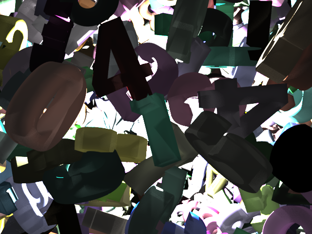

circusmonkeyHey guys, Is it possible to use single scatter sss with the point instance procedural? I could have sworn I had it working earlier but recently all I get is black renders.
Mike
Cannot say Ive looked into that. do you have a file ?
Rob
Sorry for the delay. Here's an example of what I'm talking about. Single scatter sss doesn't calculate from what I can tell with fast point instancing.
