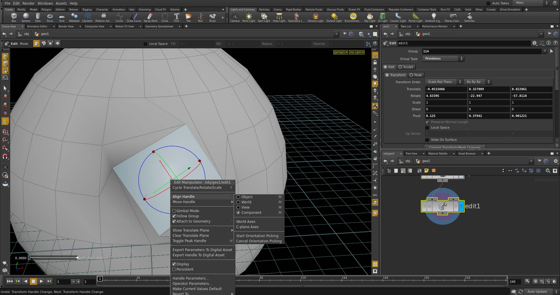

Of course you can rotate , scale each component of model such as primitives (face) along it's own axis very well in the Houdini too , Just click any primitive and press ENTER for adding Edit node automatically , then you can use component mode for local axis. (see attached pic)
