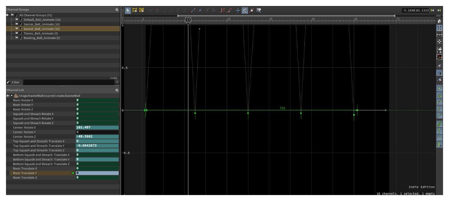

Sorry for reviving the old thread but this might help someone in the future.
Besides using Dopesheet, it can be done through a channel list(s).
Docs: https://www.sidefx.com/docs/houdini/ref/panes/chanlist.html#modify [www.sidefx.com]
To Mute/unmute individual channels from the parameter editor by RMB clicking the parameter name, and choosing ChannelsMute Channel or Unmute Channel.
Or CTRL+Mto Mute or CTRL+SHIFT+Mto Unmute.
Unmuted:
Muted:
I don't have this option! I am using H20
Edited by jomaro - 2023年11月21日 12:08:00
8158 posts
Joined: 7月 2005
I don't think you're running H20, this was a newly added feature.
