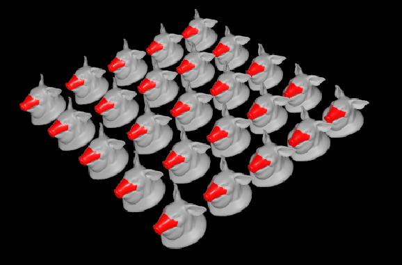

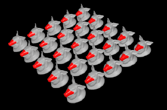

17 posts
Joined: 3月 2014
Hi, if you're still trying to resolve this, there is an easy workaround:
use name SOP to generate name attribute based on group names, then use that name to pack your geo. That will give you packed fragments based on group names (it will have Path attrib including the original group name). In the style sheet, target ‘Primitive name or path attrib’ instead of ‘Primitive group’ and you should be set.
See the picture in attachment.
