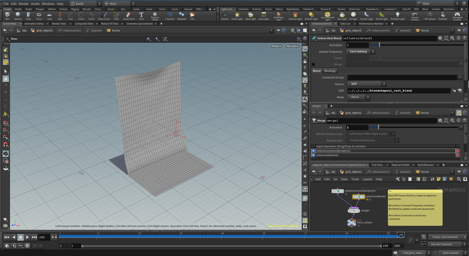

Hello Houdini community,
Has anyone succeeded to mix dynamically together the “Vellum Rest Blend” with the “Vellum Constraint Properties - Rest Length Scale”?
Its working for me only one or the other, it depends of dopnet1 / merge1 order (which Input Operator is on the top), the mixing is not working, although there is a sticky note which says:
“Wire Vellum Constraint Properties and Vellum Rest Blend to update constraints dynamically”
Any suggestion or idea is more than welcome. :-)
