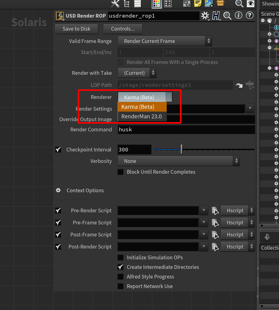

Are there any tutorials/documentation how to get (render) an image from hydra delegates(renderman/redshift/pro-render)?
I understand that I have to render scene from “stage or lop network” with usd render render node but had no luck with that with 3rd party engines(karma works just fine).
Edited by brokenkeyframe - 2019年12月5日 10:45:18
Joined: 9月 2018
“Render Settings” > followed by a “USD Render ROP”, in which their is a dropdown menu where you can choose your renderer of choice.

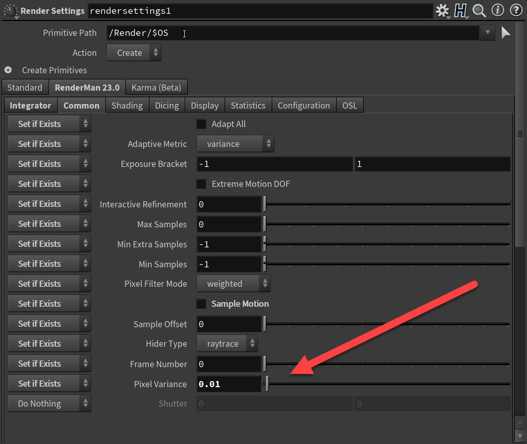

I could control the render time using the Pixel Variance.
Edited by stevenshook - 2019年12月6日 16:37:05
8367 posts
Joined: 9月 2011
stevenshook
Did you try setting the max samples? I think the default is 0 (auto) which is new in 23.
