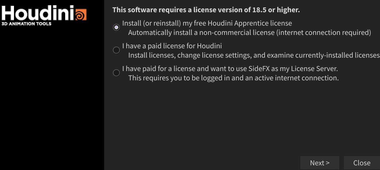

When i start Houdini, a window like this just appears and after a few seconds it closes. There are no errors, no warnings, no messages, it just closes and that's all:

As I said, I would think that perhaps the License Administrator is having a hard time connecting to the SideFX servers. The first thing that it's supposed to happen when you launch Apprentice is that you should get this window to pop up. If you haven't seen this yet, then something is preventing the License Administrator from either launching or connecting to SideFX.
If you did get the License Administrator window already, and you did install the Apprentice license then perhaps something else might be going on possibly related to a driver incompatibility.
Well, the houdini would at least display some message, otherwise it just closes and that's it. It's not serious like that.
