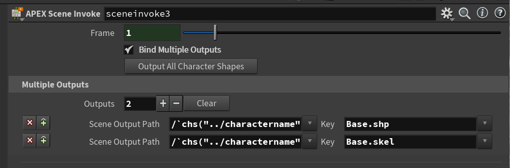

Hi there,
I have animated my character.
I want to pull the animated joints out to Kinefx.
I've looked at the "kinefx apex workflow" but couldn't find a way to get the animated pose out.
sure, you could get a controller out, but it's not animated.
Does anyone have a clue how to do that?

Just output it from Apex Scene Invoke like this:
Then Unpack Folder to get the Base.skel.
Screenshot 2024-01-10 201438.png (41.8 KB)
Joined: 6月 2015
Oh, wow, thank you. I appreciate it; it is straightforward.
