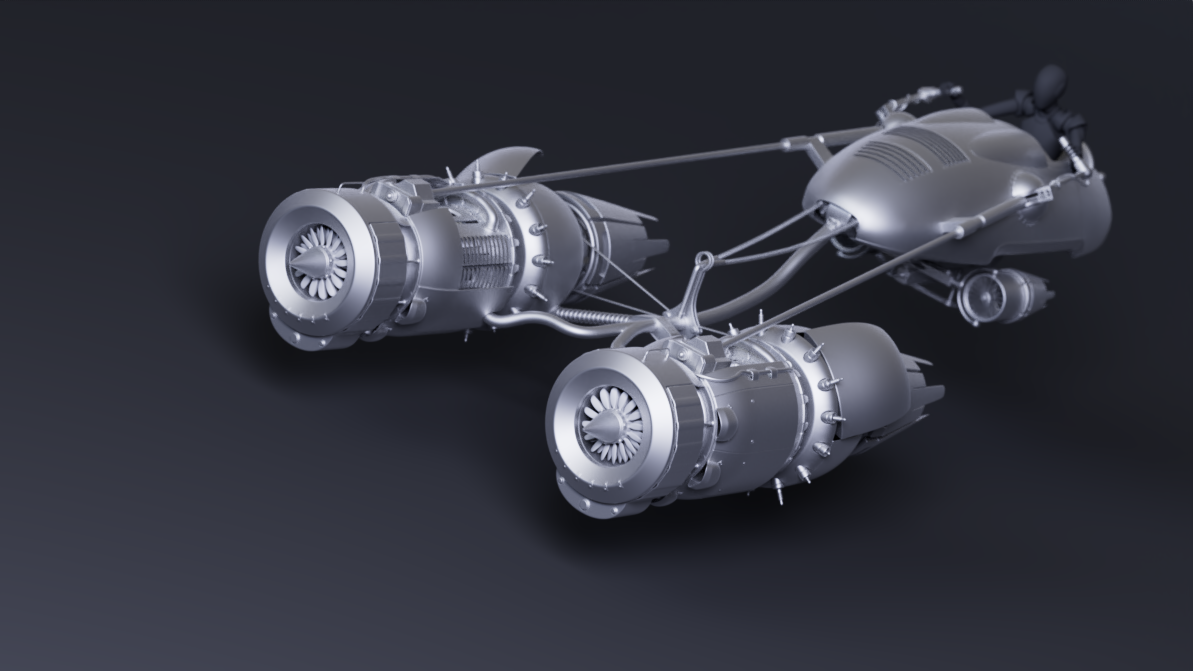

Hey folks, it's been more than two years now since I started diving into modeling in Houdini. While I was hearing only bad things about modeling , I wanted to see if there was more than people might know about it. And the short answer is, hell YEA!!!
Not only did I manage to find a way to do modeling in Houdini, but I also found a way where one can have a nice flow while modeling, and honestly as someone who modeled in pretty much all DCC's, even Plasticity, I can say that Houdini does some things much better then any other DCC, not to mention the fact that things staying procedural, even if you call it destructive modeling. That's why I started to call modeling in Houdini Hybrid modeling.
In case there are people interested, here you can find the environment and setup I am using plus some of the modeling I did:
https://miro.com/app/board/uXjVP06Hcz4=/?share_link_id=829218827858 [miro.com]
It's all Houdini and some of the textures are from Greyscalegorilla. I did not use any plugins. I also spent more than 3000h exploring/researching all of this.
Now, is everything perfect, no. Is there a potential, hell yea... a huge one, but in the end, its up to SF to decide where it pushes modeling if ever they decide to do something about it.
Cheers and stay well fellow artists.
Igor
P.S. - I have no intentions to argue against or for Houdini's modeling capabilities, I don't, I am only here to show what is possible if you try, hard.

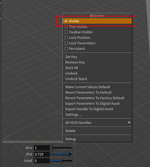

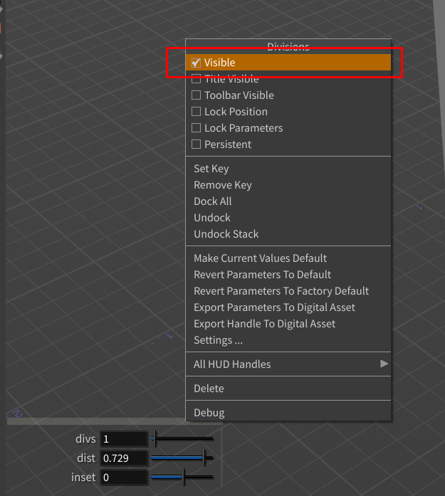

I've been experiencing another issue. I've notice the same issue in your video as well:
There are "ghost" HUD handles at the bottom left corner. I've got these from time to time. Have you found a way to get rid of them (without resetting the whole viewport)? Or have you reported this to SideFX?
Screenshot 2024-06-26 221052.png (398.1 KB)
916 posts
Joined: 9月 2018
kodra
Unfortunately that was introduced after 20.0.506 and never fixed to this day. I didnt report as I just dont wanna bother at this point. And to remove that just hover over the HUD, click right mouse button and uncheck 'Visible'.

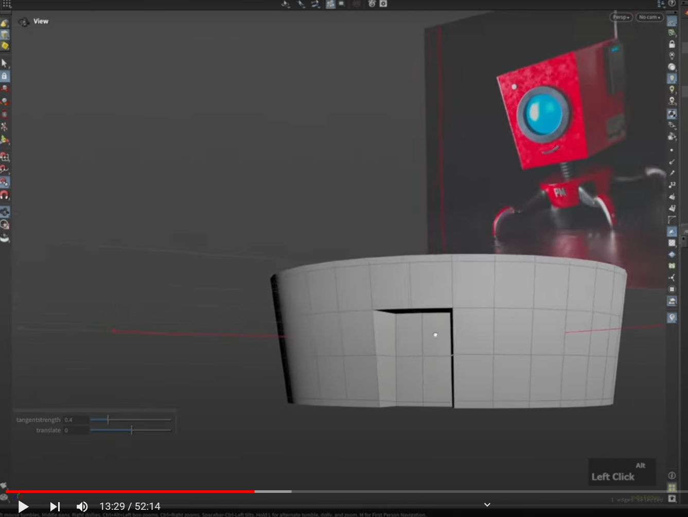

I also find a minor typo here:
Subdivide should be Alt+S right?
Screenshot 2024-06-27 003702.png (131.2 KB)
916 posts
Joined: 9月 2018
kodra
I can't. There was an important fix in 20.0.6xx about KineFX that is needed for my workflow. Thank for your suggestion though.
Ah that's a bummer. Then just report the issue to SideFX, I will too so maybe it gets fixed. Thanks for letting me know about the typo, ill uodate it right now. And yes, it's ALT + S for Subdivide.
