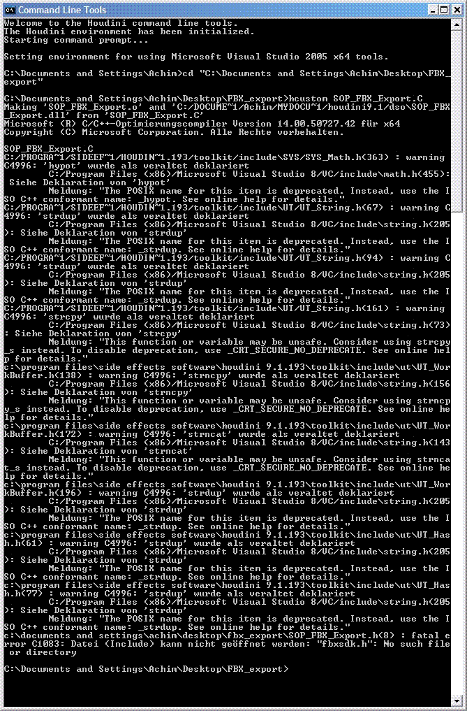

Trying to compile I receive following errors.
What's wrong?

85 posts
Regarding Windows version:
1) Someone already compile it for XP64 bit I believe
2) To install it, get the plugin (.dll) into $HOME/houdini(VERSION)/dso. If the folder dso doesnt exist, create it. $HOME by default on Windows is C:\Documents and Setting\blabla\My Documents
Then to access it, go to the SOP level and FBX_Exporter should be there.
3) Augustronic, it looks like you dont have the right HDK settings. Try to compile the example of the HDK. (Only full version of VC++ will work)
This plugin has been developed on Linux, and well I admit I didnt put my mind into Windows. It should not be a big deal to compile it though.

85 posts
Right I will retify
1) Victor compiled the DSO for WinXP32 (see above)
2) Compile for 64bit I dont have a machine available right now but I could try to do it if no one managed before me. I cant remember if compiling on Windows is Houdini build specified as it is on Linux though.
3) Augustronic I remember seeing this kind of error on WinXP 64 even for the HDK examples. I cant remember what I did to overcome it, cause it was sometime ago.
