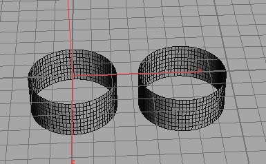

Hi everyone , I have 2 model need to be combine together , well , actually is not only 2 , is plenty, so I cannot use “edit” or “transform” node to manual edit them 1 by 1.
I need some help , please kindly let me know as much tips as I can. (except with manual edit like “transform” or “edit” node , well , if there is expression can do the samething , please also tell me !!
Thanks please!!!
Thanks please!!!

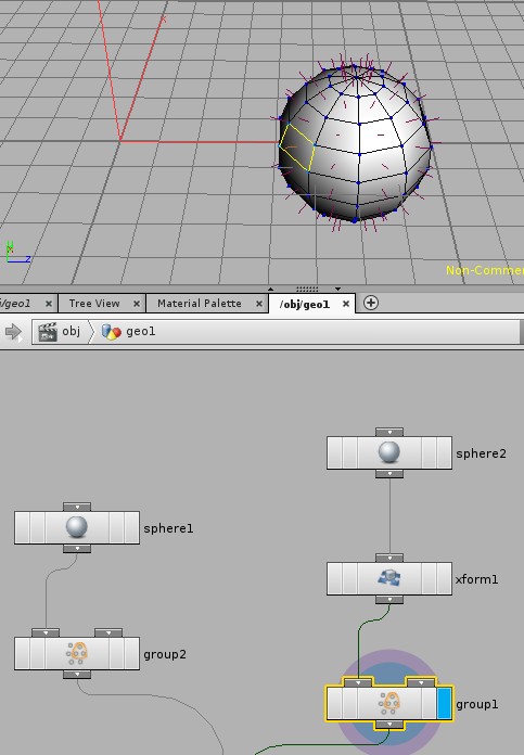

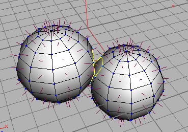

I have made a little VOP SOP for you which will align first input geo to the second input geo by 2 primitives (one from each geo)
you just set two primitive numbers
and then you can correct the placement by angle parameter
it is very fast built, so it may be buggy
it will not work correctly if the two primitives you want to align have normals pointing in exactly the same direction(very small chance, but when you are testing it and place 2 exact spheres next to each other and try to align primitive 0 to primitive 0 it will happen)
It can be easily fixed by inserting the transform node before the first (or second) input and set the rotation to very small number just to introduce small difference in normals of the chosen primitives
