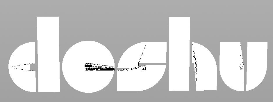

12 posts
Joined: March 2012
Hello everyone.
I folowed the steps in tutorial, and my vector imports a bit messed up.
I am attaching 2 files - preview, and the ai.
Ah, and i am using houdini v12 (free)
Thanks in advance
deshumyfont.ai (24.5 KB)
