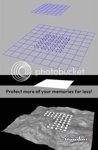

Antoine, the problem is that I plan to copy a lot of very small geometry (think small pebbles/stones) over a very large area, and I'm afraid that much of that geometry will end up below, or floating above the surface if the res is not high enough. Take a look at the pic, the little yellow box is supposed to be the scale of a human being, now imagine a small stone sitting next to it. Obviously the terrain would need to be subdivided A LOT more, otherwise any displacement map would alter the surface of the terrain too much for the pebbels/stones to appear where they're supposed to be.

Thanks for prodiving a picture: I can now give a couple more concrete suggestions.
1) group the polys around your human, and subdivide only those (subdivide heavily, as you said!) (I'm assuming the stones are only around the human). If not, subdivide wherever you're planning to put stones.
OR:
2) add an attribute to each stone which contains the uv of where the stone hit the surface (doable via the collision POP, though with polys, you might have to color the geometry according to UVs, and then extract the hitcolor and stuff it into uv). Now that each stone has a UV, add a displacement shader to the stone, that uses the same map as the ground, but since each whole stone will have the same uv's all around (inherited from the hituv/hitcolor), the stone will get displaced in Y by the amount that's meaningful at wherever it landed. In other words, use displacement mapping to reposition the *entire* stone according to the height field.
– Antoine
- Siavash Tehrani
- 710 posts
- Mario Marengo
- 941 posts
Antoine Durr
… Now that each stone has a UV, add a displacement shader to the stone, that uses the same map as the ground, but since each whole stone will have the same uv's all around
May I suggest a slight variation on the theme?
Why not displace the points after projection?
What I mean is: displace the points that got projected, not the grid they get projected onto.
During the projection step, get the surface position P, surface normal N, and any other attributes you may need to drive the displacement. Then pipe these projected points to an exact duplicate of your displacement shader, except implemented as a VexSOP (instead of a VexSHOP) – likely, this just involves copying VOPs from one context to another.
It's really just a tiny variation on Antoine's second suggestion, but I thought I'd mention it anyway.
Good luck!

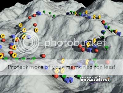

Hey DaJuice,
Here's your hip, modified to use the method I suggested – very simple: a couple of copy/pastes and a few parameter drag'n'drops.
The only slight complication came from the fact that that “bumpnoise” vop you were using, was originally restricted (for no good reason) to the displace and surface contexts only. So I just copied its contents and created a new vop-type without those restrictions. It's embedded as “MultiCtxtBump”.
I also rayed the points because it was faster to prototype, but that doesn't mean you can't stick to the POP system you set up.
Everything is tied to the shop Terrain. To drive the locations of the spheres, just change the parameters of that shop – everything else changes accordingly (including the visualization geo). So there's no need to touch anything else.
Here's your modified hipfile [members.rogers.com].
And here's a pic:
Cheers!
