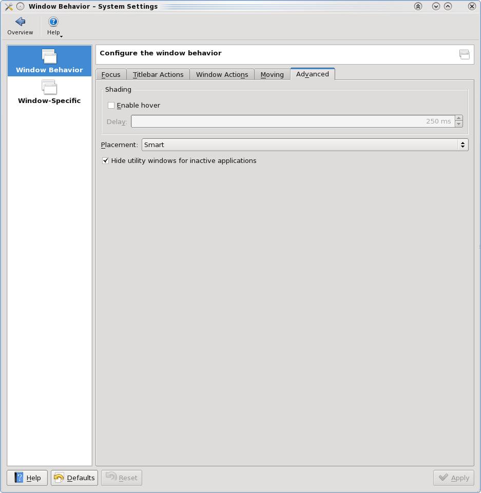

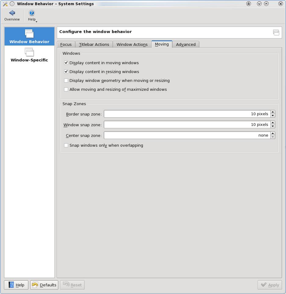

Setup 1: (work)
-Centos 6.4
-KDE 4.3.4
-Kwin window manager
-Desktop Effects DISABLED
-2 monitors, both 1920x1080
-3 virtual desktops
-Euphoria GL screen saver
-In a fit on anal-ness I am attaching screenshots of all my window settings. If I missed anything let me know!
-GeForce GT 630, driver 319.23 (upgrading to 331.17 soon)
