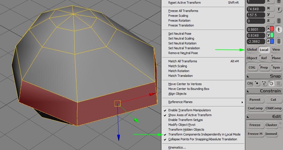

Hi guys,
It's time to jump on the band wagon.
One thing I'm finding strange in Houdini is the lack of “local space” on selections. There is only view and world.
In softimage you can choose “local” with the added bonus of moving components independently in local mode. This makes it easy to quickly move points, edges or polys on their normals, without having to use something like the peak tool in Houdini.
This makes it possible to translate on the x and z as well.

There is a local space checkbox just above the viewport when using the edit sop. Also there is the peak tab in the edit sop as well.
