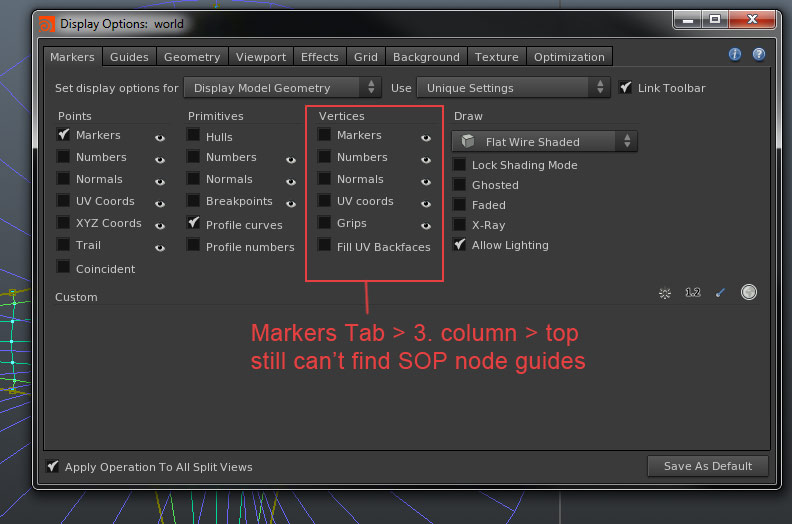

2. Those are SOP node guides. You can either turn them off in the display options, or append any SOP that is not a UVPelt.
Can't find it in the display options
It's in the Markers tab, top of the third column.
The SOP node guides?….no (see attachment)

Sorry, Guides tab.
210 posts
Joined: Jan. 2014
Ah ok, that's why I am so confused. I tried that one before and it doesn't change anything….at least in this context.
