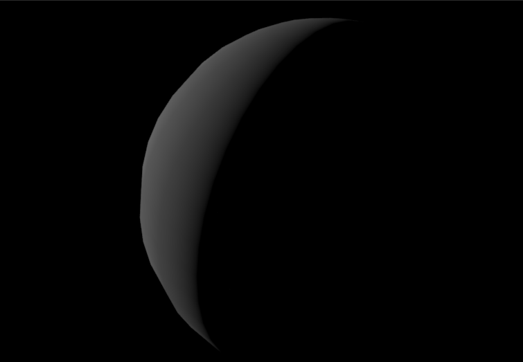

This is called the “terminator artifact”, and other renderers usually compensate for it. It involves adjusting the bias on a per-sample basis. (I even have some mental ray shader code somewhere from the stone age that does it – as the computation had to be redone after bump mapping.)

The wonder of the internets: I found the code in a blog post about 7 years old. (There's both code and explanation there.) Perhaps the same thing could be done in a mantra shader.
https://blueriviera.wordpress.com/2008/07/31/how-to-recalculate-shadow_tol/ [blueriviera.wordpress.com]
The reason I needed this for was, although mental ray compensated for this artifact correctly, if you wrote a bump shader you had to recalculate the tolerance by hand, otherwise this arfiact reappeared. (I remember it annoyed the hell out of me at the time.)

But why they keep this value so low by default? What possible artifacts if increase it too much?
The value has to be as low as possible, or else you'll get another artifact, namely shadows getting “detached from objects”, something like this:

halfdanrivieraOh, God. My past comes back to haunt me.
Mine too, if that's any consolation.
Btw, how about implementing this thing in mantra then?
Or would it cause trouble elsewhere?

Btw, how about implementing this thing in mantra then?Or would it cause trouble elsewhere?
Yes, mantra should do some thing avoid this. Render as subdivide is not able in some situations.

Sorry to bump an old thread like this, but in case anyone finds this thread in the future, the issue was fixed in Houdini 15.0.

pusatWell, I knew it had been fixed because a few of us had strong opinions about it, and were eager to see the results when someone decided to tackle it. It's been fixed since the first public version of 15.0.
Is this a recent fix? If not, how did you know it was fixed?
The way the fix works is not 100% obvious that it'd work in most cases, but it seems to do well unless you have geometry close to a low-res curved surface. For example, two boxes with point normals near each other may get odd shading artifacts, but who has boxes with point normals? *cough*cough*
It's also apparently in the What’s new in Houdini 15: Lighting, shading, and rendering [sidefx.com] page, but I didn't know that until I checked the commit logs. :wink:
