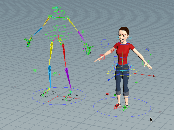

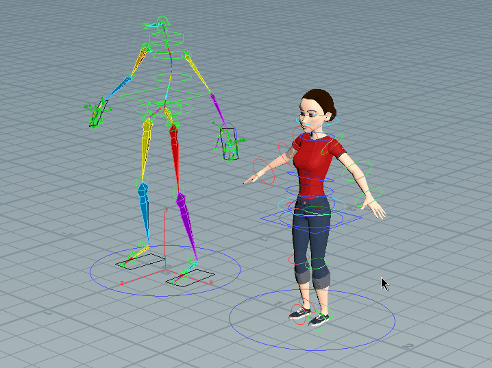

Just saw the masterclass on rigging and really enjoyed it! Thanks!
Nice walkthrough of the features, and even though the tool is very intuitive, the thinking behind it is even clearer now
However there are a few really big issues with the autorig, as of 16.0.557.
I'm sure you are aware of them but here are the main ones that essentialy make the rig unusable:
1. Hand does not follow the arm when in FK mode, and feet does not follow the legs.
2. Upper body does not follow when rotating COG
3. Upper body does not follow when translating COG
4. Head does not follow when scaling the MASTER
I've attached gifs and hipfile.
I must admit I find it a little strange that you are releasing the master class wiuthout fixing these obvious bugs. I love the tool, and it seems so thought out so it's a petty that we can't start playing around with it because of these bugs.
Is there an ETA on a fix?
Edited by alexsomma - April 3, 2017 02:26:45
AutoRigBugged.hip (515.4 KB)
VFX Supervisor @ Helmet Films & Visual Effects
http://www.helmet.no [helmet.no]
3466 posts
alexsomma
this was an oversight when building the matchIKFK features - and is being resolved now.
alexsomma
there is a node called : Spine_chest_follow_COG
this node has a parameter called Weight1 - this controls the behaviour of the chest - it's wasn't promoted in the build code and this has been fix and will be in the next update
but you can promote the parameter now and use it to control if the chest follow the COG or not.
alexsomma
this will be fixed in the next update.
thanks for the feedback.
