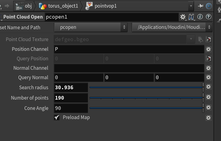

@Artye
My goal is to use Vop. The picture below shows something more in light of the smoothing I'm trying to do. You've shown me some interesting avenue with “pcopen”, but this not for this:

Hey hey Thanks for the inputs. I've uses Loops then even ended up setting up a HDA to do those summarizing operations:
As seen in the first image, I just didn't grasp how to do all the looping inside the VOP, I had to have the ICE equivalent to “Repeat” done on SOP level.
