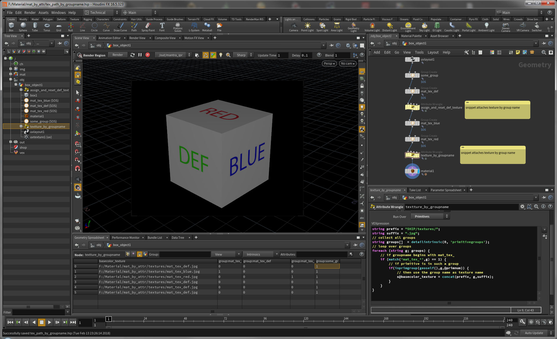

While talking with a friend…
this came up
use groupnames to assign texture names.
unfortunatly not visible in ogl preview,
maybe needs ogl texture path, too.
can be used for “shop_materialpath”, too.
Thanks to symek
“…better” uses material overrides, then the texture is visible in preview :-)
this came up
Thanks to symek
